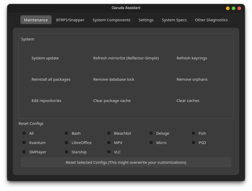

i applied the theme , but there are no icons in garuda-assistant now

Can you post a screenshot of what you are seeing in Garuda Assistant?
Hmm, that application uses embedded icons so this is kind of a weird issue.

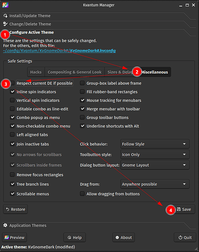

Can you try this please:
  1. Open Kvantum Manager
  2. Click “Configure Active Theme”
  3. Open the “Miscellaneous” tab
  4. Uncheck the box that says “Respect current DE if possible”
  5. Save
Then relaunch Garuda Assistant and let me know if the icons show up.
they didn’t.

Test if this is an issue with that theme by using a different theme from the Kvantum drop down, for example KvGnomeDark. Don’t forget to go back into the “Miscellaneous” tab and uncheck “Respect current DE if possible”.
that did it.
but i like the libadwaita theme
it was the iconless option in kvantum , i unchecked it and it’s fixed
