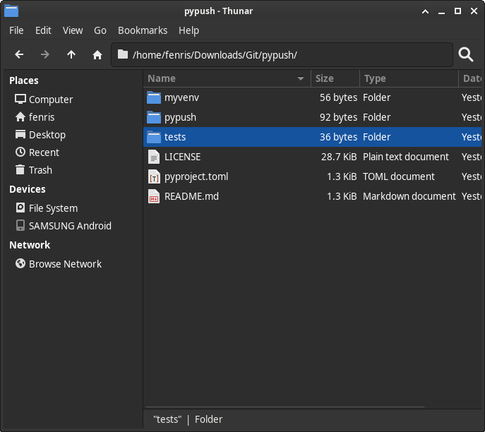

This is what happened when I follow the instructions you posted:
 ╭─fenris@fenris in repo: pypush on  main via  v3.12.3 as 🧙 took 436ms
 ╰─λ mkdir myvenv
 ╭─fenris@fenris in repo: pypush on  main via  v3.12.3 as 🧙 took 9ms
 ╰─λ python -m venv myvenv
 ╭─fenris@fenris in repo: pypush on  main [?] via  v3.12.3 as 🧙 took 2s
 ╰─λ source myvenv/bin/activate
 ╭─fenris@fenris in repo: pypush on  main [?] via  v3.12.3 (myvenv) as 🧙 took 8ms
 ╰─λ pip install -e .
Obtaining file:///home/fenris/Downloads/Git/pypush
  Installing build dependencies ... done
  Checking if build backend supports build_editable ... done
  Getting requirements to build editable ... error
  error: subprocess-exited-with-error
  × Getting requirements to build editable did not run successfully.
  │ exit code: 1
  ╰─> [14 lines of output]
      error: Multiple top-level packages discovered in a flat-layout: ['pypush', 'myvenv'].
      To avoid accidental inclusion of unwanted files or directories,
      setuptools will not proceed with this build.
      If you are trying to create a single distribution with multiple packages
      on purpose, you should not rely on automatic discovery.
      Instead, consider the following options:
      1. set up custom discovery (`find` directive with `include` or `exclude`)
      2. use a `src-layout`
      3. explicitly set `py_modules` or `packages` with a list of names
      To find more information, look for "package discovery" on setuptools docs.
      [end of output]
  note: This error originates from a subprocess, and is likely not a problem with pip.
│ exit code: 1
╰─> See above for output.
 ╭─fenris@fenris in repo: pypush on  main [?] via  v3.12.3 (myvenv) as 🧙 took 24s
I think the problem now should be handled by whoever made that thing you are trying to install
Looking at it a second time, I think your virtual env myvenv should be outside the project directory.

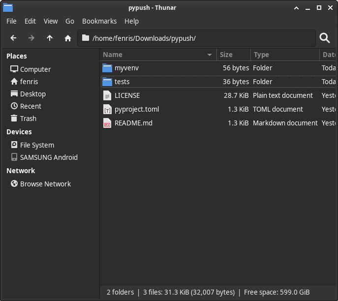

Did you mean like this?
 ╭─fenris@fenris in ~ as 🧙 took 16ms
 ╰─λ cd Download
bash: cd: Download: No such file or directory
 ╭─fenris@fenris in ~ as 🧙 took 6ms
[🔴] × cd Downloads
 ╭─fenris@fenris in ~/Downloads as 🧙 took 7ms
 ╰─λ ls
drwxr-xr-x - fenris 31 May 15:24  Git
drwxr-xr-x - fenris 20 May 18:52  'Install MacOS Ventura on ESXi 7.0'
 ╭─fenris@fenris in ~/Downloads as 🧙 took 18ms
 ╰─λ mkdir myvenv
 ╭─fenris@fenris in ~/Downloads as 🧙 took 5ms
 ╭─fenris@fenris in ~/Downloads as 🧙 took 3s
 ╭─fenris@fenris in ~/Downloads via  v3.12.3 (myvenv) as 🧙 took 10ms
ERROR: file:///home/fenris/Downloads does not appear to be a Python project: neither 'setup.py' nor 'pyproject.toml' found.
 ╭─fenris@fenris in ~/Downloads via  v3.12.3 (myvenv) as 🧙 took 2s
I moved pyproject.toml to the downloads folder and got this:
[🔴] × pip install -e .
 ╭─fenris@fenris in ~/Downloads via  v3.12.3 (myvenv) as 🧙 took 710ms

 ╭─fenris@fenris in ~/Downloads via  v3.12.3 (myvenv) as 🧙 took 5s
Something like
:file_folder: Pypush
├── :file_folder: mvenv
├── :page_facing_up: example
└── :page_facing_up: file
In that case, I have this setup…
Then I tried this…
Then I get this…
 ╭─fenris@fenris in ~/Downloads via  v3.12.3 (myvenv) as 🧙 took 22ms
 ╰─λ cd pypush
 ╭─fenris@fenris in ~/Downloads/pypush via  v3.12.3 (myvenv) as 🧙 took 6ms
Obtaining file:///home/fenris/Downloads/pypush
