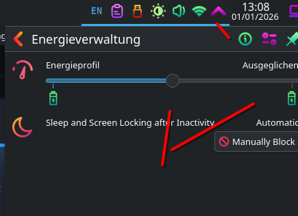

Hi,
I dont have Intel Cpu actually but did you try other power Settings ?
Your Cpu Temp is a bit high is this on a Idle State?
may the Cpu trottle down itself because of the Temps my guess. Did you have changed any Bios Settings?
Yes, that temperature was idle, apparently performance power plan always kept my cpu temps high due to my cooler being bad. Setting it to balanced actually fixed the lag, thanks!
may replace it with a better one and check the Termal Paste on it :wink:
