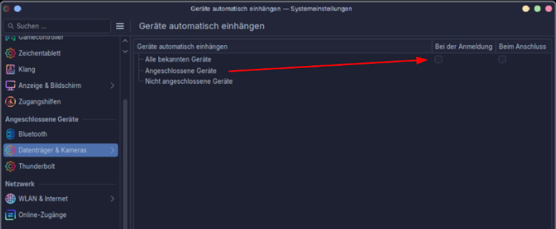

Which settings exist for “auto” mount in plasma ?
Perhaps faulty metal (cable, usb port, chipset, drive, power supply) ; connect, post: lsblk -f (both usb drives); i hope no entry in /etc/fstab for usb and if with the right options.
Think on it, some metal from the system is current more then 10 years old.
KDE Plasma Automount
i can auto mount drives.
