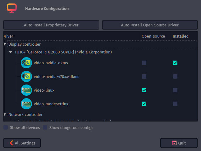

But in hardware configuration i see only video-linux and video-modesettings drivers.
If your are talking about Garuda Settings Manager → Hardware Configuration settings, maybe your window isn’t wide enough to show the other checkbox field? It should report that video-nvidia-dkms is installed.
Everything is fine with the settings screen. But I don’t have a button there to automatically install proprietary drivers and there’s also no video-nvidia-dkms and video-nvidia-470xx -dkms although I installed them via the command line
Odd. Sounds just to be an issue squarely on the Hardware Configuration screen. Might be because the card is pretty new and isn’t set up correctly to be shown yet.
