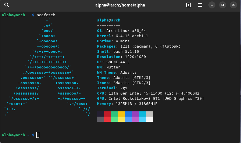

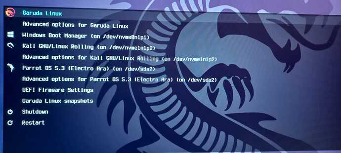

hi, I have several operating systems on my PC, Grub Garuda does not recognize Arch Linux

Yes, it is installed, but it is not recognized in Grub Garuda

I believed that Arch was installed, but it needs to be mounted in Garuda before update-grub.
Yes, I updated Grub several times after installing Arch Linux

╰─λ sudo update-grub
Found theme: /usr/share/grub/themes/garuda-dr460nized/theme.txt
Found linux image: /boot/vmlinuz-linux-zen
Found initrd image: /boot/intel-ucode.img /boot/initramfs-linux-zen.img
Found fallback initrd image(s) in /boot:  intel-ucode.img initramfs-linux-zen-fallback.img
Found linux image: /boot/vmlinuz-linux-nitrous
Found initrd image: /boot/intel-ucode.img /boot/initramfs-linux-nitrous.img
Found fallback initrd image(s) in /boot:  intel-ucode.img initramfs-linux-nitrous-fallback.img
Found initrd image: /boot/intel-ucode.img /boot/initramfs-linux.img
Found fallback initrd image(s) in /boot:  intel-ucode.img initramfs-linux-fallback.img
Found Windows Boot Manager on /dev/nvme0n1p1@/efi/Microsoft/Boot/bootmgfw.efi
Found Kali GNU/Linux Rolling on /dev/nvme1n1p2
Found Parrot OS 5.3 (Electro Ara) on /dev/sda2
Adding boot menu entry for UEFI Firmware Settings ...
Detecting snapshots ...

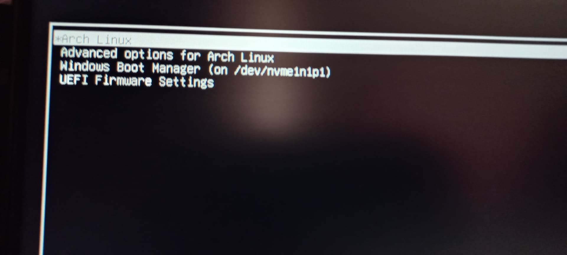

There is nothing in the efi folder in Arch Linux
I have installed it several times and every time I restart it, it gets deleted
# mount /dev/sda3 /boot/efi
# sudo grub-install /dev/sda3
This could be the problem?

Arch linux root partition /dev/sda4
╭─lion@garuda in ~ took 30ms
╰─λ sudo mount /dev/sda4 /mnt
Found Kali GNU/Linux Rolling on /dev/nvme0n1p2
Found Windows Boot Manager on /dev/nvme1n1p1@/efi/Microsoft/Boot/bootmgfw.efi
I install it and it is installed

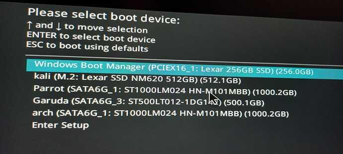

In the first box you reinstalled grub in the Arch ESP partition, but you will be using the Garuda GRUB not the Arch one. The os-prober doesn't care of the other grubs, it just looks for bootable entries.
The difference after reboot could be due to the fact that in the second box you might be searching in the Garuda ESP, not the Arch one as before.
Anyway I'm sorry, I dual boot Garuda and Arch on a laptop with no problems since years, but I don't have it with me in this period to check the details.
I don't recall I did anything special.
Maybe try installing in Arch lsb-release but I doubt it will help:
https://wiki.archlinux.org/title/GRUB#Arch_not_found_from_other_OS
While os-prober is designed to detect other operating systems on different partitions, typically there will only be one EFI partition on a single disk. I’m not sure os-prober is designed to handle multiple EFI partitions on the same disk–from what I understand, it expects to find bootloader information in a common EFI partition.
Having two EFI partitions on the same disk can cause other issues related to bootloaders and OS installation, so it would not surprise me to learn it causes issues with os-prober as well. Actually, having two EFI partitions on the same disk can cause major issues with Windows–for example, Windows will refuse to install on a disk that already has an EFI partition. You may be fine to keep using it since the installation is complete, but I would be nervous to update that bootloader.
My advice is to boot to your Arch installation, unmount /dev/sda3, mount /dev/sda1 at /boot/efi (assuming that is where you have mounted the EFI partition in Arch), reinstall the Grub bootloader, regenerate the Grub configuration file, amend /etc/fstab with 5136-968F as the UUID for the EFI partition, reboot to confirm that the updated configuration works as expected, and then delete the /dev/sda3 partition and delete the old EFI boot variable with efibootmgr or from the UEFI setup utility.
Then, re-scan with os-prober from Garuda.

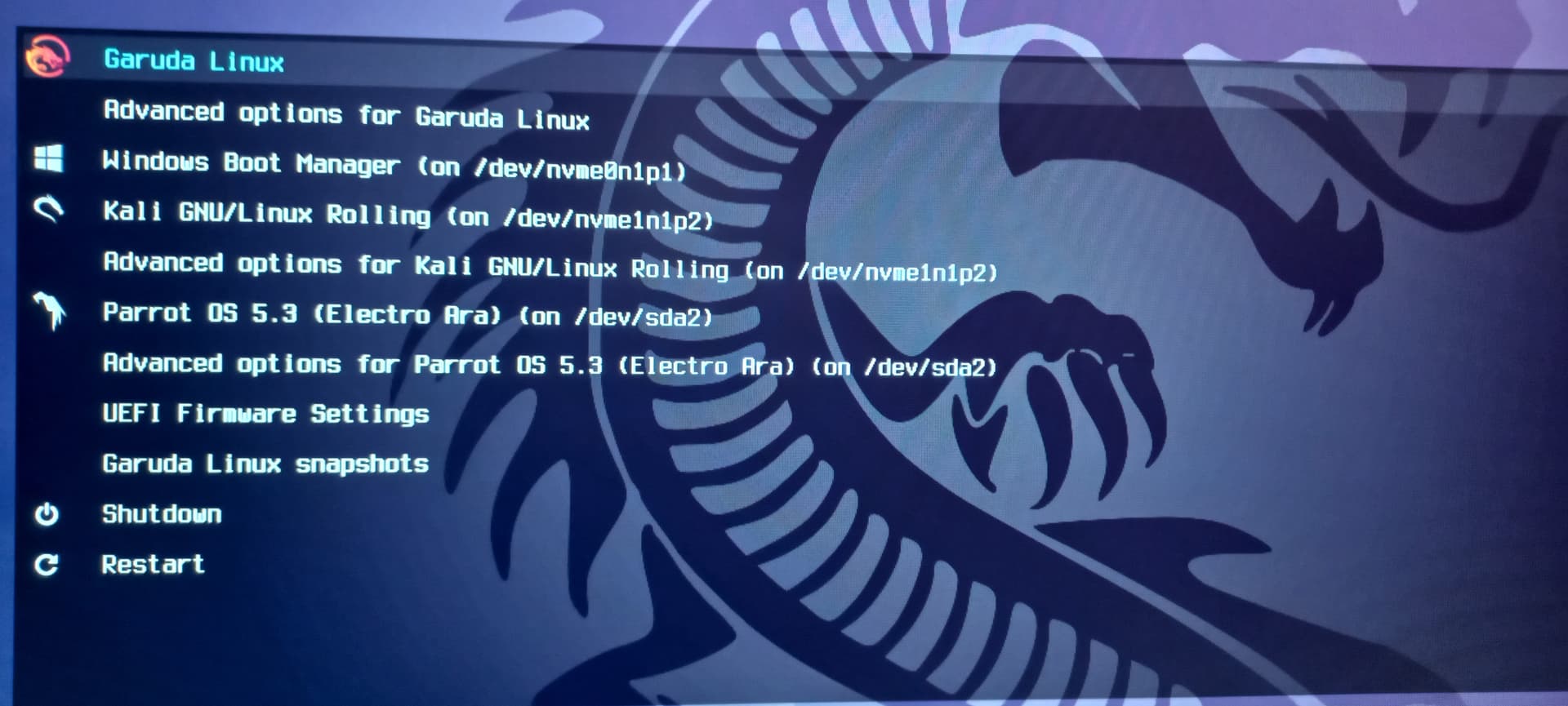

The problem was solved؛
I had installed Arch Linux and Parrot in one disk, with two partitions efi
I deleted one of the efi partitions, And I installed two grubs on one efi partition
Found Arch Linux on /dev/sda3
