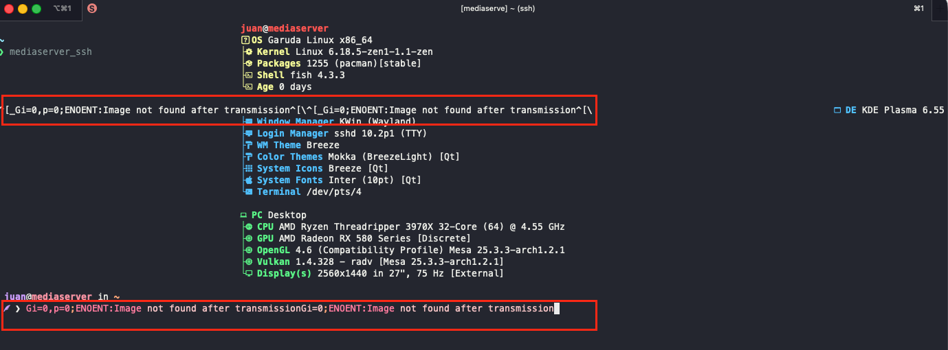

I have just installed Garuda Linux Mokka on my computer. When I log into an SSH session from macOS, it shows this:
I suppose this error is due to the image that is displayed when entering a fish session with fastfetch.
This is caused by the default configuration that Garuda installs with Fish. I believe that fastfetch shouldn’t run when the session is opened via SSH.
Thanks.
This can be easily solved by adding a test to the conditional statement that decides whether or not to execute fastfetch:
## Run fastfetch if session is interactive and is not SSH session
if status --is-interactive && type -q fastfetch && not set -q SSH_TTY
   fastfetch --config mokka.jsonc
end
