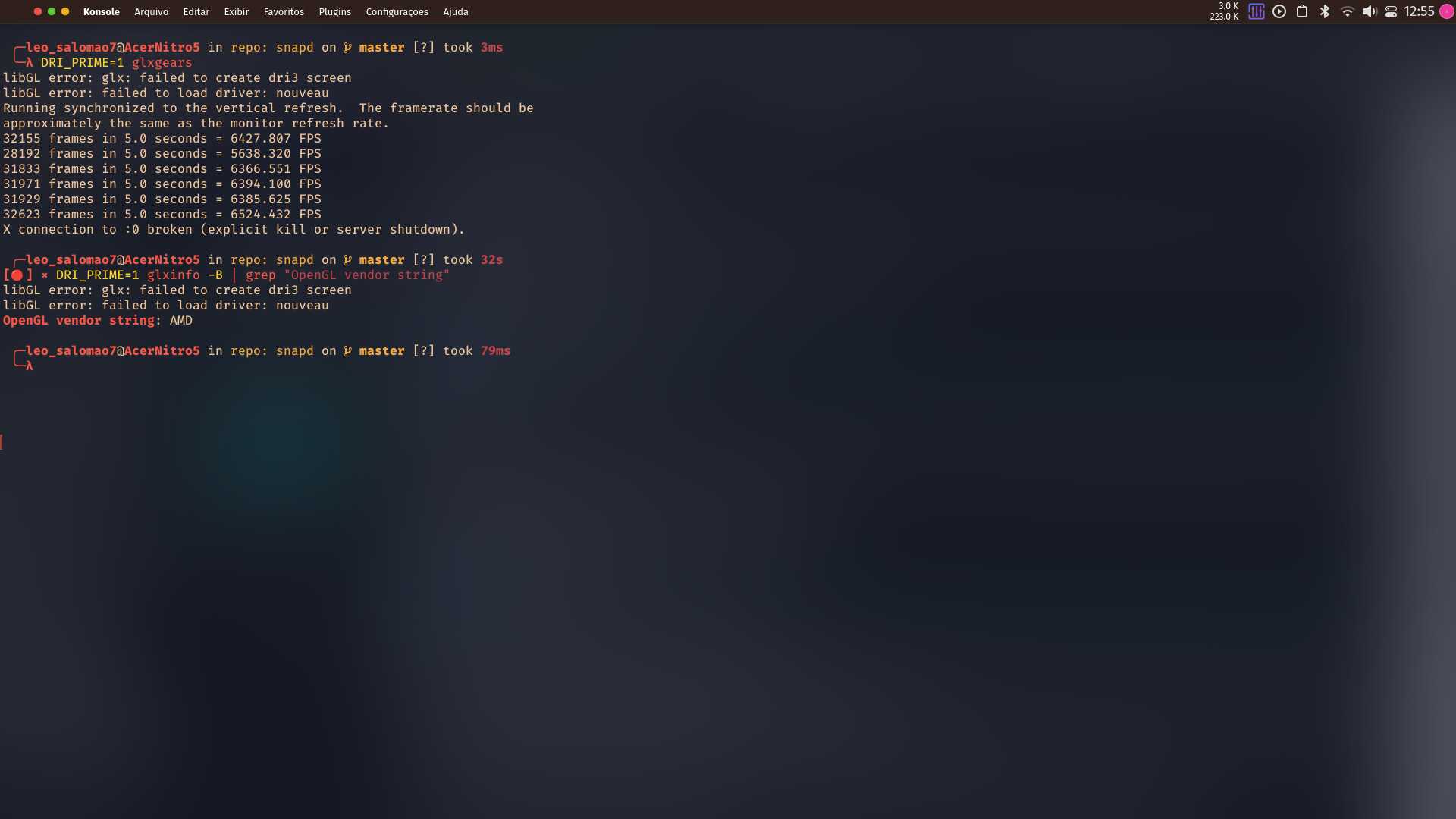

â•─leo_salomao7@AcerNitro5 in ~
╰─λ DRI_PRIME=1 glxgears
libGL error: glx: failed to create dri3 screen
libGL error: failed to load driver: nouveau
Running synchronized to the vertical refresh. The framerate should be
approximately the same as the monitor refresh rate.
31592 frames in 5.0 seconds = 6318.363 FPS
33463 frames in 5.0 seconds = 6692.537 FPS
33170 frames in 5.0 seconds = 6633.946 FPS
32318 frames in 5.0 seconds = 6463.532 FPS
X connection to :0 broken (explicit kill or server shutdown).
â•─leo_salomao7@AcerNitro5 in ~ took 22s
[đź”´] Ă— DRI_PRIME=1 glxinfo -B | grep "OpenGL vendor string"
OpenGL vendor string: AMD
â•─leo_salomao7@AcerNitro5 in ~ took 63ms
╰─λ
