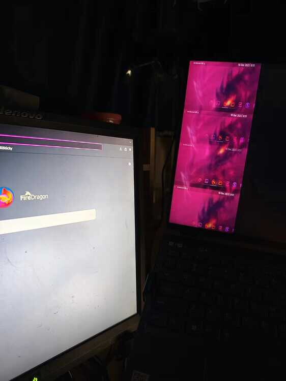

Sometimes it was blurry when I started it before it was repaired:
In Garuda Live, I selected the Nvidia boot option. At this time, it worked normally in both X11 and Wayland and could use two screens. After I installed the system and booted it up, the driver seemed to get a bit weird. It could not read my second monitor normally, both in X11 and Wayland.
I got some packages from another system to fix the dual screen display in X11, but the problem still exists in Wayland:
yay -Rsc --noconfirm --noprogressbar --nodeps lib32-nvidia-utils xf86-video-nouveau
yay -Syuq --noconfirm --noprogressbar --needed nvidia-hook nvidia-prime nvidia-dkms nvidia-settings
nvidia-installer-kernel-para nvidia-drm.modeset=1 add
I hope that after I install the system, I can use Garuda’s built-in driver to display normally without frequently operating anything.
