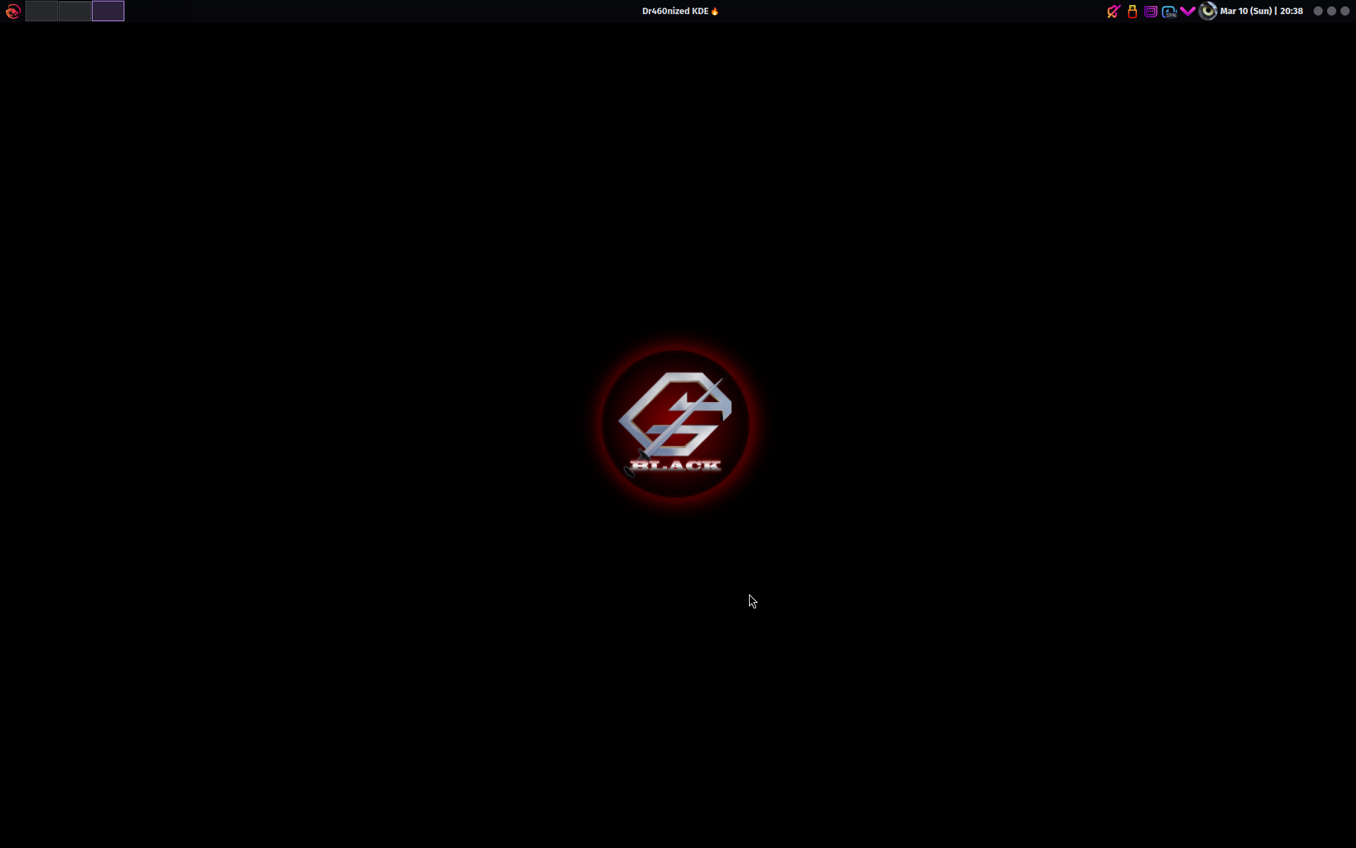

Power And Battery system tray won't show battery percentage
It just shows an icon instead:
Screenshot_20240309_150942
Left clicking the icon shows the details:
Screenshot_20240309_151135
I have tried to disable and re-enable the entry and restarted the PC.

It’s a KDE feature, not a bug? :wink:
Open an issue on KDE, please.
I issued a bug report. The people at KDE said that you need to right click and tick “Show battery percentage icon”.
I already had that ticked, but the option was a bit different, it said “Show battery percentage icon when not fully charged”. So I drained one percentage point and I could see the charge percentage. It was reaaaaaaaaaaaaaaaaaaally small text. And the size of the text is tied to “General” in Fonts under Text & Fonts in System Settings.
(example of said really small text)
I think it will be changed in coming updates.
