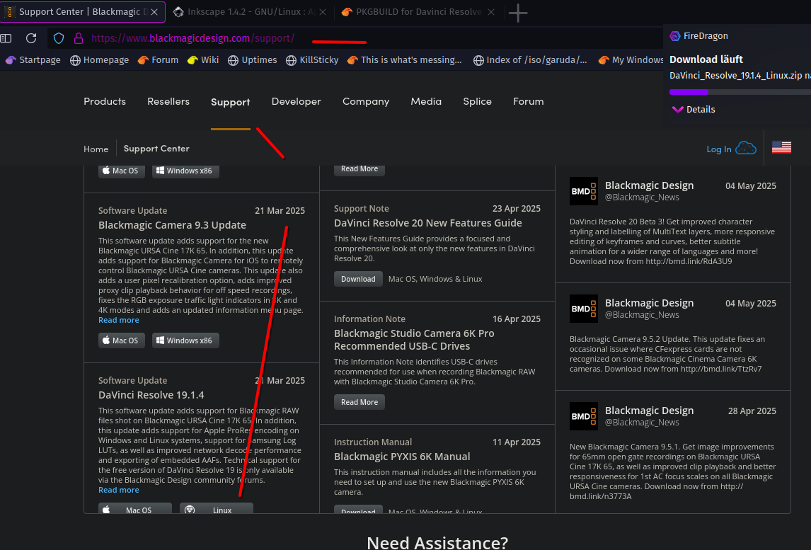

you can execute the appimage directly no install or move for installing IIRC :wink:
you need a zip file for it .

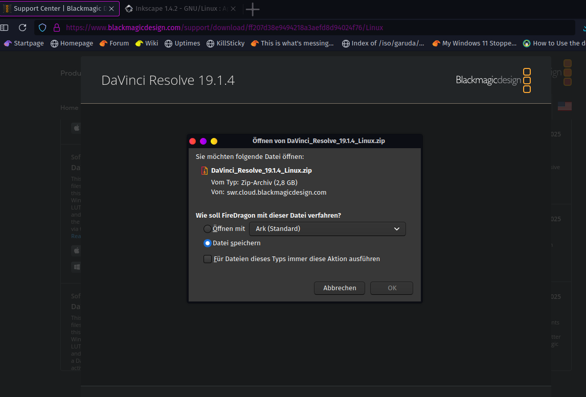

you have to fill out a form then you can download it .
scroll down to find it :wink:
move the downloaded zip file to the folder where you downloaded with git then makepkg again :wink:
ps installed it and worked with the zip file :wink:
Download the zip file and copy or move it with any file manager either to ~/.cache/paru/clone/davinci-resolve/ if you are using paru, or to ~/.cache/yay/davinci-resolve/ if you are using yay. Then try to build the package again.
