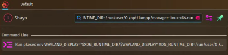

If I click on the menu icon on the top-left corner, and type in the same command in the search, and then click to execute in KDE, nothing happens:
I’m at a total loss on how to figure this out. Back in the day I used to use kdesu or gksu but I understand these tools are now deprecated/not recommended and that pkexec is the proper way to do it.
I do see other applications like Btrfs Assistant or KDE Partition Manager automatically prompt for the user’s password to elevate privileges for that application to run - so how do I do this for the GUI Control Panel from XAMPP?
