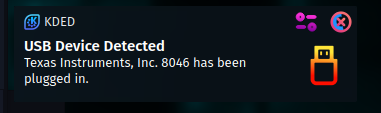

Hey folks,
Kind of at my wit’s end on here… Recently, my garuda has started to make notification sounds (without a pop-up) and I cannot, for the life of me, track down what event triggered the notification sound.
I did go through System>Notifications>System Notifications and just going through the list and playing the sounds for the various system notifications and the sound it plays sounds a lot like the “device plugged in” and “device unplugged” sounds. So, I also checked the box for “show a message in pop-up” but nothing pops up, so not sure if it’s that.

This doesn’t indicate the timestamp of the events, but it’s happening every few seconds.

I only have 3 usb devices plugged in: keyboard, mouse, integrated webcam in my Dell monitor. Once I unplugged it, the errors and notifications seemed to have stopped after some time.
I then installed KSystemLog and noticed similar errors to what I was seeing with udevadm except now it’s showing:
Priority: Error
Unit: Kernel
usb 2-9: Failed to suspend device, error -19
When I unplug the webcam from the usb, I get this error:
Priority: Error
Unit: libvirtd.service
internal error: Missing udev property 'ID_VENDOR_ID' on '2-2'

I’m not sure what may have changed, but it seems like it may be related to a newer kernel? For now, I have it unplugged because I don’t really use the webcam, but this feels like something I should be able to fix. Any guidance or help on the direction I should take would be greatly appreciated!
Thank you!
