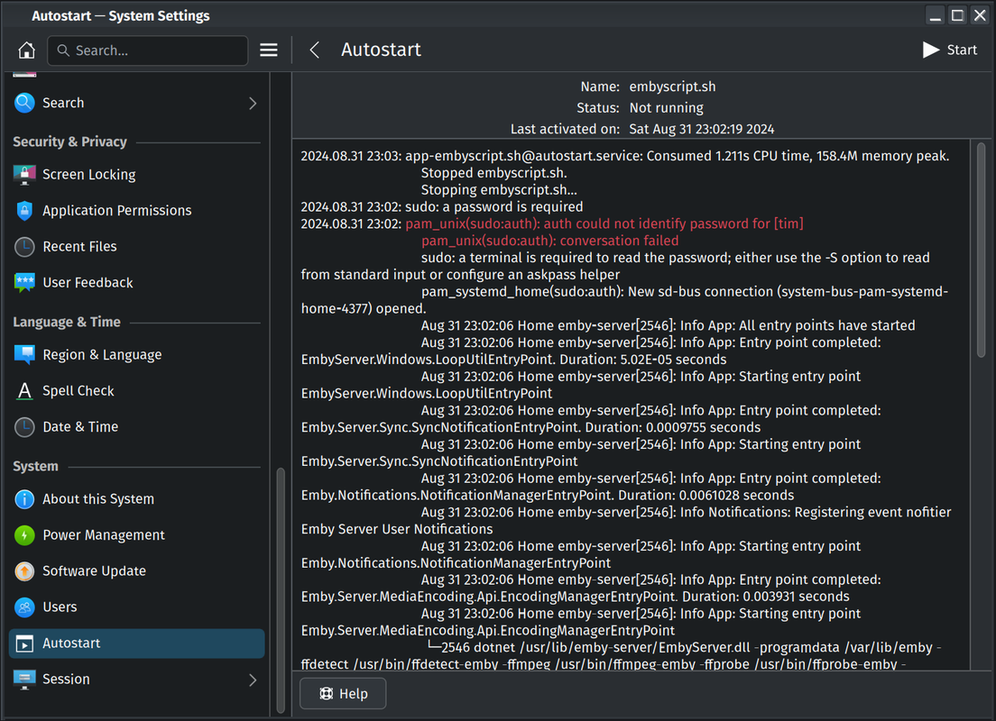

Thanks for the input. I got it to work once because it asked for my password when booting to desktop but now after a restart it doesn’t ask for the password so it fails to run the sudo parts of the script. It should not be this hard to get something simple to work, shaking my head.
Script
#!/bin/bash
sudo systemctl start emby-server      # Start the service
sudo systemctl enable emby-server     # Start the service on bootup
sudo chown -R tim:media /run/media
sudo find /run/media -type f -exec chmod 664 {} +
sudo find /run/media -type d -exec chmod 775 {} +
sudo find /run/media -type d -exec chmod g+s {} +
Autostart output
Autostart Output
Regards,
Tim
