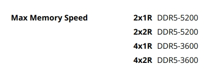

This usually happens with incorrect CPU/RAM settings or a power supply that is too weak. Check all settings in the BIOS - especially vcore, P-State, C-State, timings, etc.
Even though 7800X3D has memory speed touted at 6000MHz as being the sweet spot, the official support is 5200MHz for 2 slot config:
One thing to also try is disable EXPO. If it fixes the freezing, you can enable it and go down with the speed until it is stable.
