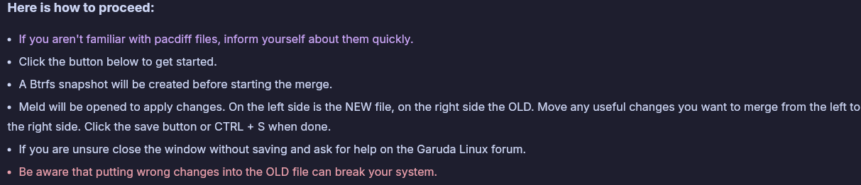

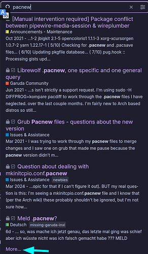

I could not find anything on the forum when I searched for this. I tried making my self familiar with this but every time I try I break the system and updates no longer work so a total re install is required or (I can restore a snapshot) but this merging thing keeps popping up after so many updates if a reinstall is done or it is just back if a snapshot is used. This is on both my computers. I thought about just ignoring it but the Rani still shows the warning and it bothers me a bit. So I was wondering if there was is a simple way to fix this.

I just move the new server list to the right side and save it. When it asks to delete the pacnew file I first say N that I still have the file.
Then I check by upd -a and get the WARNING aabut when it’s done run the command again then this WARNING doesn’t come up anymore.

Thanks and my apologies, I did search the forums and nothing came up. I do recall that the contents of that screen shot. This does confuse me a lot, I feel like I should be able to get this working so I just delete the file and not merge ? I feel so dumb, why does this make me want to go off and cry. I was trying to figure it out on my own. thanks

Thanks, I get it now. I did include it later. Doing a duckduckgo/ startpage / searx was part of what lead to my confusion. None of the results were garuda related so not helpful and I included the link the rani provided as proof I was using garuda as the link was provided by the error but didn’t find the info at the link helpful and was more confusing. From this point on I will include the needed info. Not trying to hurt the forum, I love this software and love the community as every one is really kind even in this. I just want to be honest to also be helpful. I do thank every one for being helpful.
