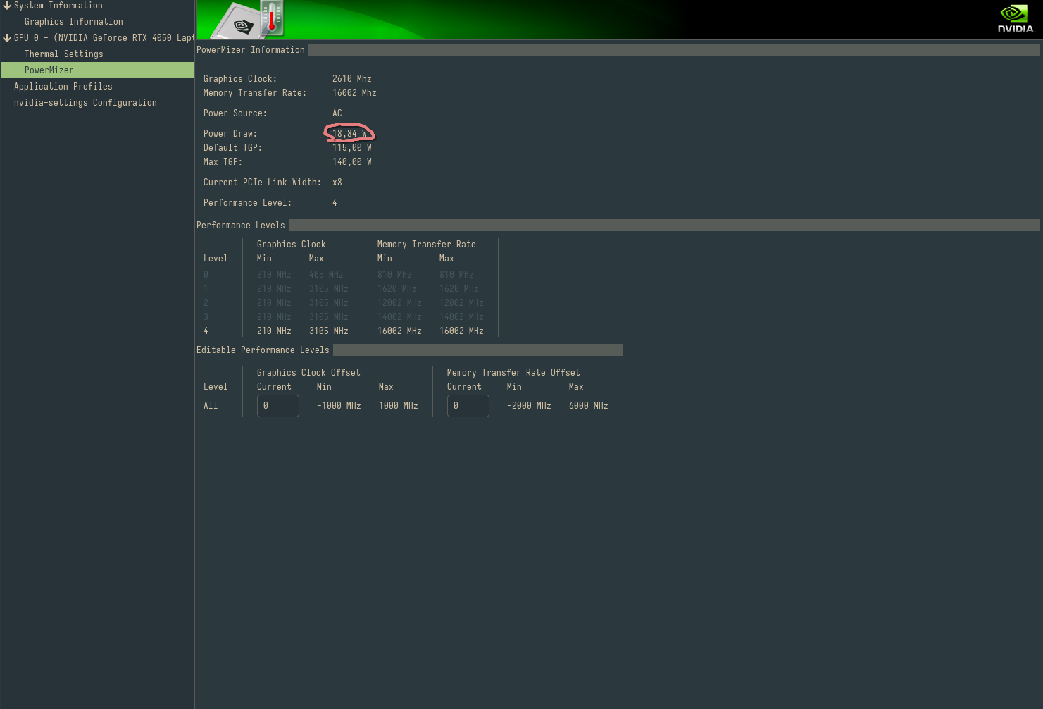

I am having a problem for quite a white, when I am gaming o my notebook, there is no problem at all, but when using my monitor, I noticed that the fps would drop significantly to 20-30 range for some seconds, and go back to normal, and this would go on and on, this would happen even on low end games. Investigating this i found that the temperature was normal, but the power draw was fluctuating when this fps drops occured:
In The witcher, using as exemple, in game it would be at 90 W or something, but it would drop to 30 W or something. I tried a lot of things and am kinda lost right now, if anyone got a clue, I would greatly appreciate it.

Since yesterday I got an update, I was wrong apparently, the power draw is happening using only my notebook as well, sorry for the confusion. Anyway, here is my inxi:
