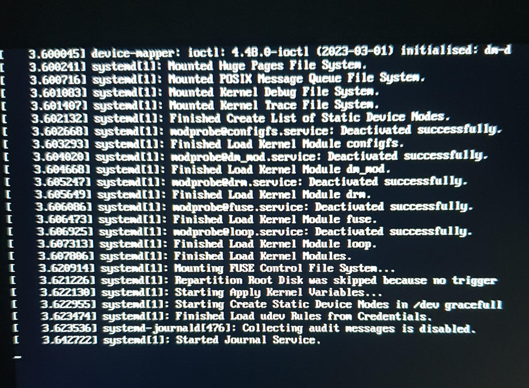

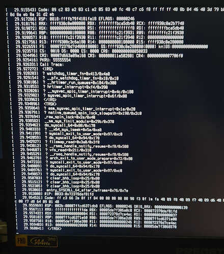

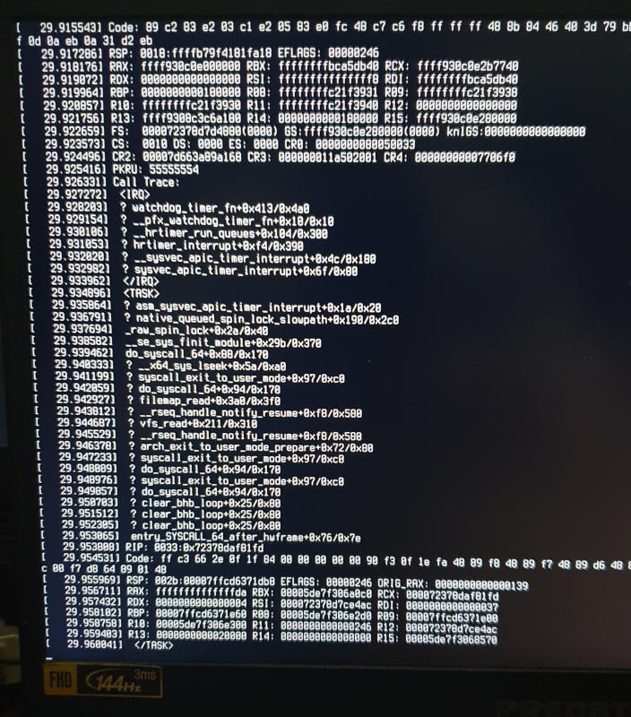

Well, it boots fine with linux-zen kernel.
With linux-cachyos, I tried booting twice, and got 2 different outcomes
