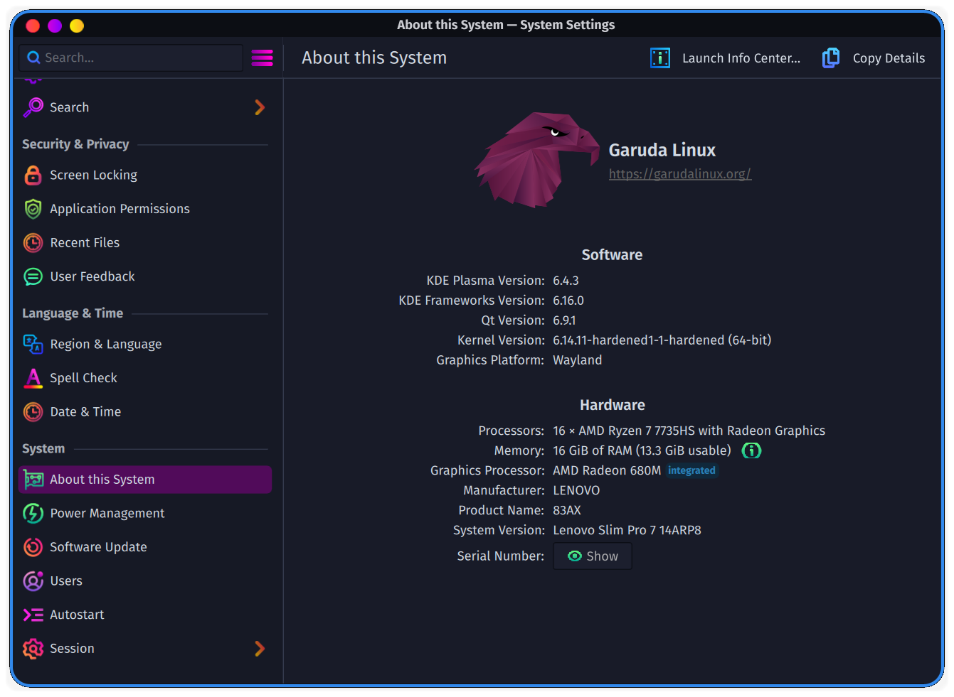

Kernel: 6.14.11-hardened1-1-hardened arch: x86_64 bits: 64 compiler: gcc

Desktop: KDE Plasma v: 6.4.3 tk: Qt v: N/A info: frameworks v: 6.16.0
Type: Laptop System: LENOVO product: 83AX v: Lenovo Slim Pro 7 14ARP8

Device-1: NVIDIA GA107BM / GN20-P0-R-K2 [GeForce RTX 3050 6GB Laptop GPU]
vendor: Lenovo driver: N/A alternate: nouveau non-free: 550-570.xx+

Broke after a fresh install; have not configured anything; have switched to mostly AMD only have a few systems with nvidia still and most are laptops; initially thought it was bad timing; that the nvidia hardened kernel driver was not available; you make it seem like it is an exploit though. Or maybe this happened from choosing the proprietary driver option from ISO install?
Of course that`s the issue
Boot ventoy (with grub2 option) β†’ use option open source (no prop. nvidia driver)
β†’ install β†’ reboot β†’ install apps/kernel β†’ update β†’ reboot β†’ then install the
right driver for your dgpu. (my mind)
If you do this, you don’t need to uninstall the nvidia stuff only install.
Fix seems to work from the terminal output.
Graphics switched from the 3050 to integrated 780m gpu after though.
Looked up ways to switch it; there are a number of solutions for arch.
Any recommendations for the best way to do this for Garuda?
Much appreciated.

Did a fresh install with open Nvidia drivers; integrated is showing up as dedicated in settings; 3050 is showing up in terminal. Can not find a tool to change the from integrated to dedicated might have missed something. Much appreciated.
Please, edit your last post until someone replies. :slight_smile:
How is that? Working on many things here. Sorry if am missing something.
Found this tool that supposedly works in Ubuntu.
Not sure if this is the same thing but for arch.
There is also … garuda-hardware-profile-nvidia-prime
Guessing NVIDIA settings would not have that capability.
I think you might have to drop the hardened kernel. All your issues go back to it, Maybe read more up on it. Or you have to manually some how disable the igpu, don’t know if you can do that in your bios or not. But either way I think some core research would help you.
