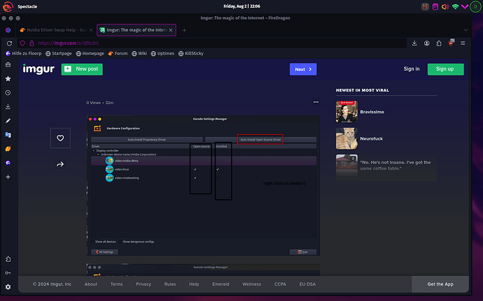

You are currently with the proprietary drivers, otherwise the open source kernel drivers are nouveau.
I think the easiest way to switch is using the autoinstall proprietary or open source drivers with the relevant buttons in Garuda settings manager → HW configuration
PS: welcome to the forum!
yes thats the way to work with it. in my case i dont need to play on high fps because my screen resolution and i switched to my internal gpu in the mainboard settings and have no wake up issues with nvidia anymore=)
I have clicked on that button and rebooted. I also took the moment to disable my onboard video as I do not use it at all. Below is the output of garuda-inxi:

I believe the best way forward is to determine why that button to switch them doesn’t work for me.
Thanks for your help, but I’m more interested in making the switch buttons work rather than doing anything manually at this stage. I WILL reinstall the OS if I have to.
Which button did you press?
Should be autoinstall open source drivers, not the one for proprietary drivers.
But I seem to remember now that that screen had some problems in the past with some GPUs.
can you make a screenshot which switch button you mean? i have hooks and do right click for remove or reinstall the open driver?
This is my step-by-step:
Please see above! :slight_smile:
yes thats why ive said if you want remove ot reinstall it . you want install open source but it is allready installed check the hooks in the middle stay left Opensource right Installed by video-linux and hock also on Open source on video-modesetting.

I’ve got video-linux “open source” checked and installed. Does my garuda-inxi indicate I have open source or not? What does open source look like? What is the string, where should I expect it in this output?

I cannot reinstall the video-linux open source drivers by right-click reinstall because
Starting
> Removing video-linux...
Sourcing /etc/mhwd-x86_64.conf
Has lib32 support: true
Sourcing /var/lib/mhwd/local/pci/video-linux/MHWDCONFIG
Processing classid: 0300
Sourcing /var/lib/mhwd/scripts/include/0300
Processing classid: 0380
Processing classid: 0302
checking dependencies...
:: removing garuda-video-linux-config breaks dependency 'garuda-video-linux-config' required by garuda-nvidia-prime-config
Error: pacman failed!
Error: script failed!
Done ...
So do you suggest a burn-down and reinstall with onboard video disabled and choose open source at setup? Because this is kinda getting frustrating lol.
