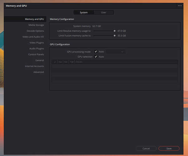

Issue with Nvidia 560 driver installed from Official repository, however cannot install driver alongside DKMS package. Also I need the driver to use Davinci Resolve which is unable to see the driver since it’s not installed. Not sure if Garuda can make 560 driver available via it’s own repos? in any case providing inxi:

Do you have cuda installed?
An one recommendation when you get a working davinci resolve you should set it to the ignore list so its not updated tell its absolutely needed. You may have to build davinci agents the new driver or might have to downgrade it. Though i would start on the arch wiki
https://wiki.archlinux.org/title/DaVinci_Resolve
Will verify in a few. not currently in front of PC. Appreciate the quick feedback. To be honest don’t think I have cuda installed, but I’ll know for sure in about an hour.
Sir you’re the best. installing the two Cuda packages resolved my issue with Davinci Resolve.
