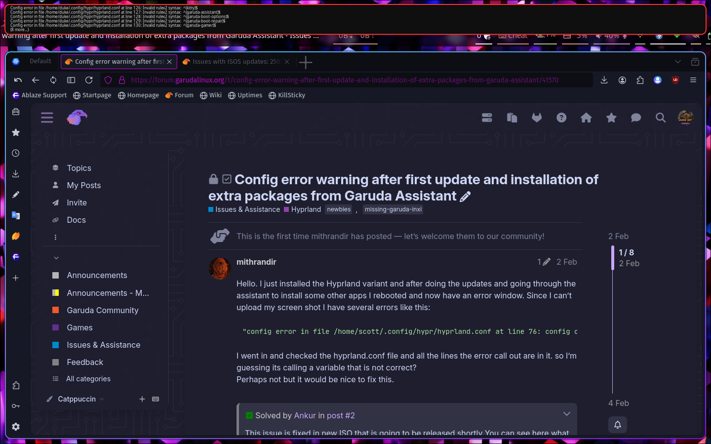

After a quick view to both files there is some difference in on monitor section is auto. I did copy those file in the .conf but same issues i have to check the iso file but not today.
I’m getting the same issue:
I was embedding a screenshot but it says I can’t do that because I’m a new user…
All I did was say yes to the Garuda “special” flavor or whatever it prompted me for. Now I can’t see the main menu.
Garuda Hyprland Linux Zen 250308.iso

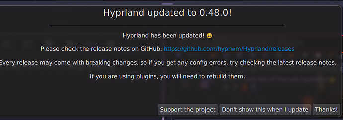

v0.48.0 [Latest]
  • windowrule v1 syntax is gone. windowrule now behaves like windowrulev2, deprecating the windowrulev2 keyword
Just comment the lines you see in hint message on top

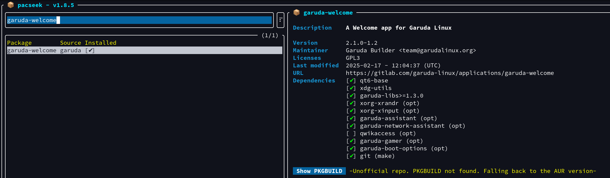

Do I need to modify the titles? For example, it seems that “garuda-welcome” no longer exists, and a new one, “garuda-rani,” has been added.
Edit to your liking :slight_smile:
pacman -Qi garuda-welcome

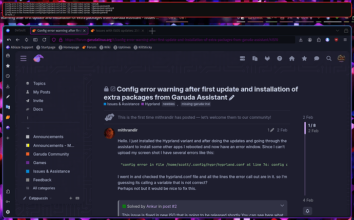

thanks @SGS i have seen this line in the config file and did it for testing and did it back also put the # in front and so on :wink: thanks for the hint and link to the newer version :wink: i will play arround its nice :wink:
So i checked the iso and its the 0.47.2 version after the update 0.48 the new one :wink: config is the same file. Just for knowledge;)
thats the trick its written down but says class :wink:
i chanced all error to it and worked fine without delete the warning line. thx SGS
