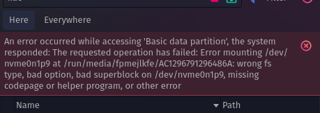

An error occurred while accessing 'Basic data partition', the system responded: The requested operation has failed: Error mounting /dev/blahblah: wrong fs type, bad option, bad superblock on /dev/blahblah, missing codepage or helper program, or other error

Might have time to setup a pure Arch system at some point. Switching one drive to EXT4; after shredding both; second is getting formatted as NTFS in arch this time. Most concerning is Bluetooth turning on; Steam crashing Arch to the point of needing a restart; it happening on multiple systems like clockwork.
