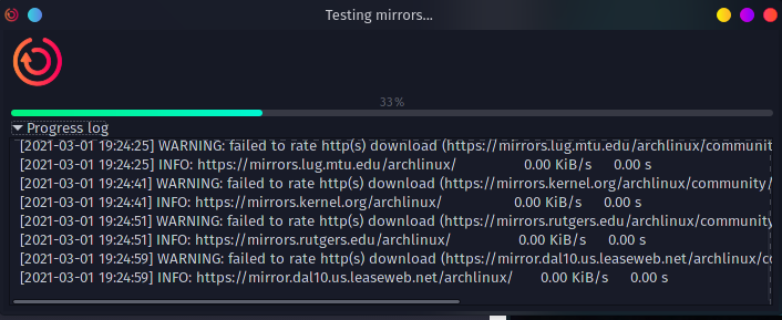

No mirrors/ No active or running mirrors!
I'm not getting any active mirrors or speed mirrors(literally of any speed >0).
I got this issue in installed os on my system nor i am able to get it in live os :frowning:

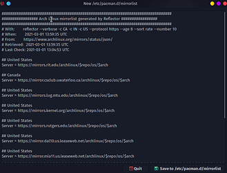

I actually searched for other similar issues in the forum, but may be i couldn't get accurate, some said adding worldwide or other countries fixed,
But actually the problem for me is i am getting mirrors but all are 0kbps
So, now the major problem i am getting in is for updating my os and for doing any work that involves terminal to connect through mirrors :((
I faced this same issue in my previous installs too, but reinstallations fixed and now repeating again, but in previous installs i had other issues too which i couldn't offer time to debug, but now i gotta clear this out, btw thanks for any solutions offered below :slight_smile:

I do this yust know
[2021-03-01 19:47:25] WARNING: failed to rate http(s) download (https://arch.mirror.square-r00t.net/community/os/x86_64/community.db): Download timed out after 5 second(s).
[2021-03-01 19:47:38] WARNING: failed to rate http(s) download (https://mirror.telepoint.bg/archlinux/community/os/x86_64/community.db): Download timed out after 5 second(s).
[2021-03-01 19:47:46] WARNING: failed to rate http(s) download (https://archlinux.mailtunnel.eu/community/os/x86_64/community.db): Download timed out after 5 second(s).
[2021-03-01 19:47:59] WARNING: failed to rate http(s) download (https://mirror.f4st.host/archlinux/community/os/x86_64/community.db): Download timed out after 5 second(s).
[2021-03-01 19:48:07] WARNING: failed to rate http(s) download (https://mirror.lty.me/archlinux/community/os/x86_64/community.db): Download timed out after 5 second(s).

but anyways, if i run reflector simple and search for us/canada/sweden/switzerland/uk or some any other country, it still shows me 0kbps
and when i gave only one as worldwide some showed up with speed and output gave only one mirror.
but i can't understand why all other mirrors are @ 0kbps, and as i saved those 0kbps it gave me same error of "unable to lock database" which solved after executing "upd"...
