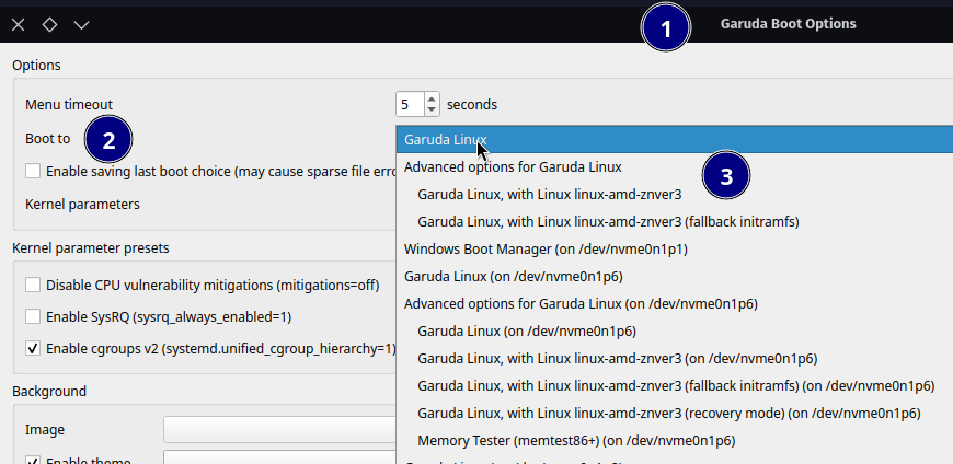

After adding:
snd_hda_intel.dmic_detect=0
to grub and updating grub I had working sound!
On subsequent boots it did not have sound. ![]()
I updated grub again but still no sound.
