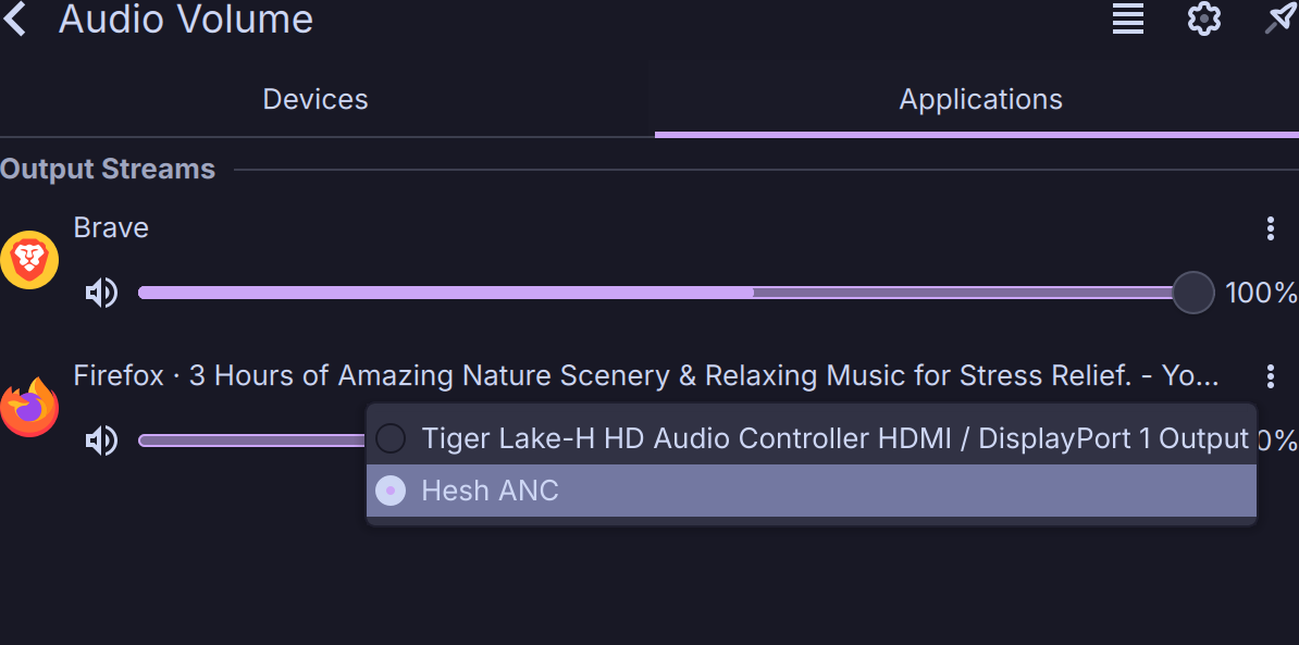

So recently something weird started happening.
Randomly I lose sound in Firefox. It works everywhere else. In Brave, Audacious, MPV player, no issues.
But in Firefox, nothing.
In the “Audio Volume” menu in the Applications tab sometimes I do see Firefox and the sound bar is moving. But there’s no audio at all coming out.
Any ideas?

Well I wrote this after about 1 hour of not being able to fix it.
Right after I wrote this I checked the sinks, and there was no sink selected for Firefox. I selected any of the available sinks, and the audio now works.
Leaving this here just in case anyone has trouble with one specific app not outputting sound in Garuda.
I still don’t know what caused this, I mean what causes the sinks to get de-selected?
