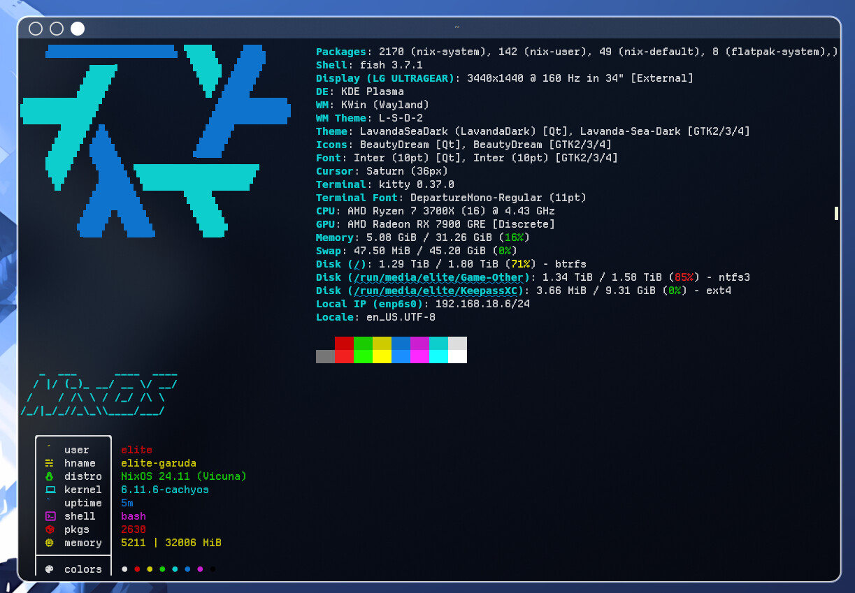

The issue looks like this. please forgive me for a image of terminal.
The top one is the one I can’t find. the bottom one is a test from the fish config.
I have also fully cleared the fish config an the top one is still there. So I’m just a little lost.

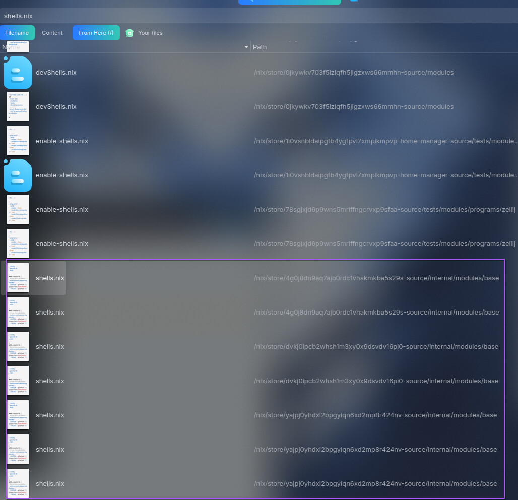

Somewhere you start fastfetch , check/see .config/fastfetch and use ugrep for searching.
ugrep -l fastfetch
But I do not use Nix :smiley:
I’m brand new to nix so I don’t know to much, but ran the command brings up a a few hundred nix/store locations and my old backups of fastfetch when i tried to make my own layout in documents.
I wonder if it gets pulled over after when the installer sets everything up? but I’m just guessing.

I found them, but I can’t modify them. If I understand right cause its nix store? But sudo nano is a no go. I might just have to leave it.
