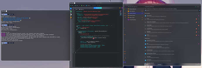

I had kwin-force-blur flake working just fine. The moment I added something else to the config an rebuilt all was fine the blur still worked. But before bed like always ran garuda-update an shut down. Power on in the morning an the blur effect is gone. Changing the flake back to normal rebuilding an all that, nothing works. You can temporary restore it if you use the vary early generations on boot with the the “Nix All configurations” an picking a old one but after a reboot its gone again.
Making subflakes an all that for either flake doesn’t allow the force blur flake to build. I’ll but my configs below, but I don’t think there is any helping it.
Main Flake with just Force blur added

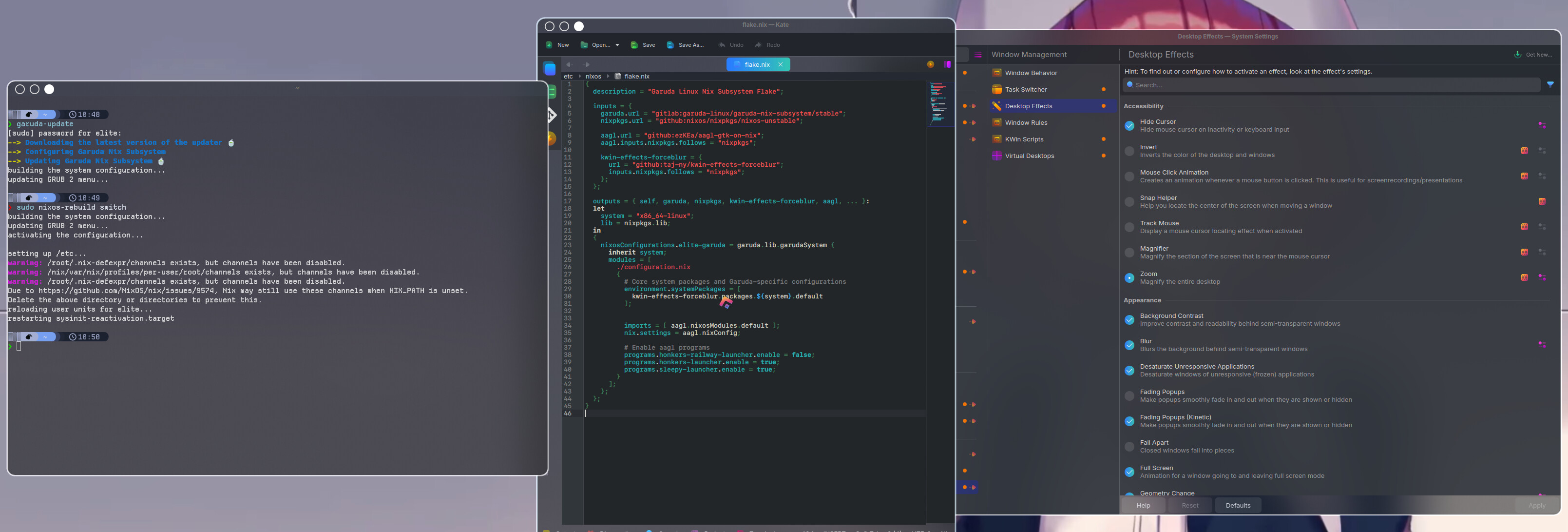

Main flake with one extra flake added. This caused the force blur problem at least I think. (Going back to the first one does not fix the issue)
  description = "Garuda Linux Nix Subsystem Flake";
