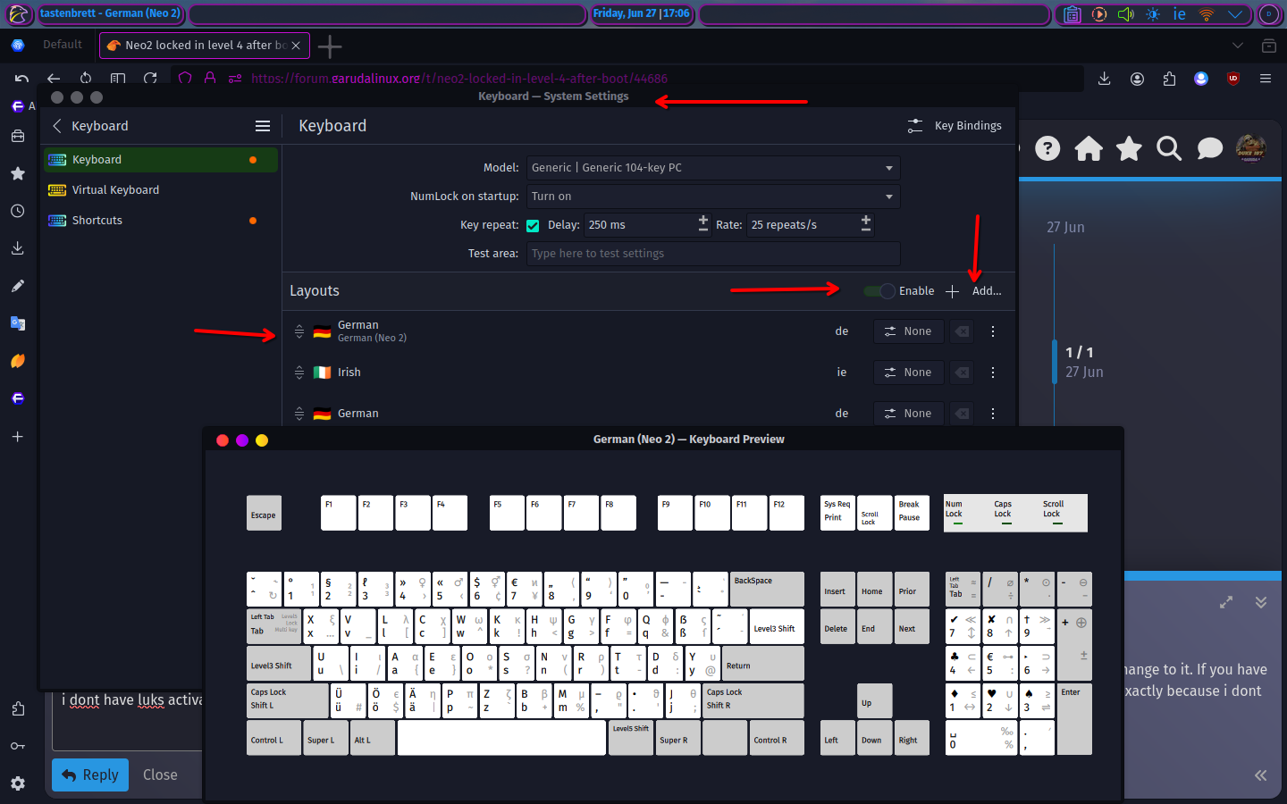

Hi and welcome,
Did you try to set it as first layout here? (if new added move it up with the burger symbol 3___)After the normal login it will change to it. If you have a Luks encryption you need to change some settings but i dont know exactly because i dont have luks activated.

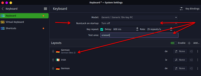

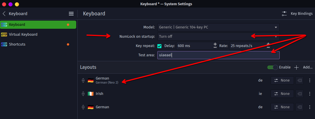

Just forgot all the Stuff lol the Solution is simple. Worked for me if we can read lol.
On the website its clear.
Before activate/switching the Neo2 Keyboard you should turn off the NUM LOCK !!! IF its activated you get locked on Layer 4.
For the reboot issue you can change the Settings here you have to activate yourself again but switch out of Neo to other Layout.

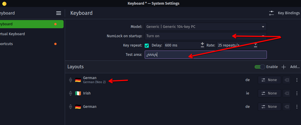

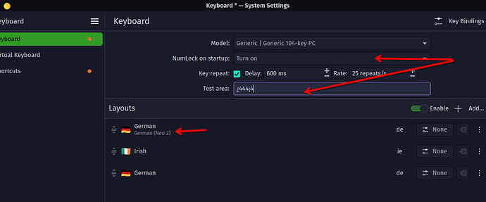

and here its locked
