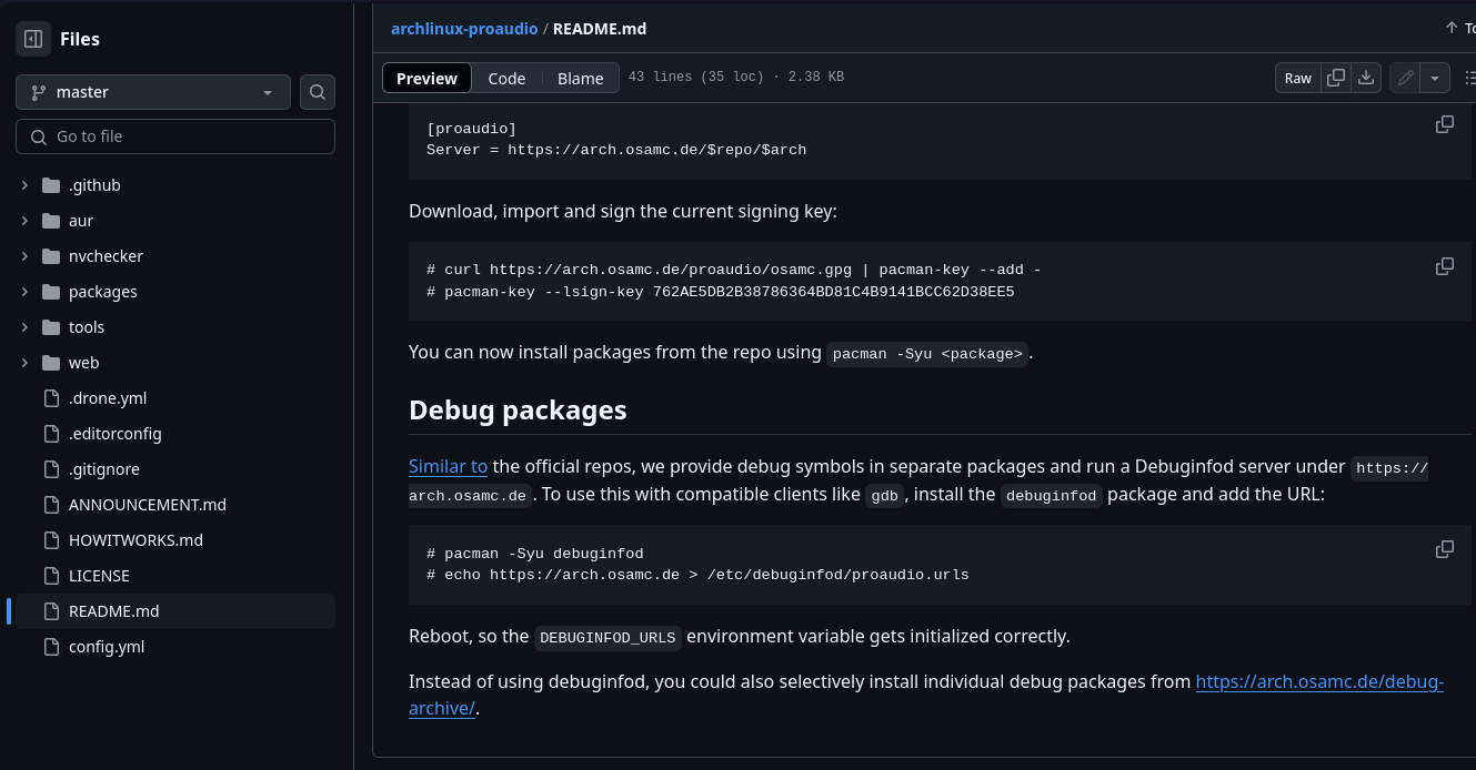

Add the repo to your /etc/pacman.conf:
[proaudio]
Server = https://arch.osamc.de/$repo/$arch
Download, import and sign the current signing key:
curl https://arch.osamc.de/proaudio/osamc.gpg | sudo pacman-key --add -
sudo pacman-key --lsign-key 762AE5DB2B38786364BD81C4B9141BCC62D38EE5
then
sudo pacman -Sy
to synchronize the database, or better yet
garuda-update
and reboot.
Try the unofficial repos.
https://wiki.archlinux.org/title/Unofficial_user_repositories
USE WITH EXTREME CAUTIONstrong text

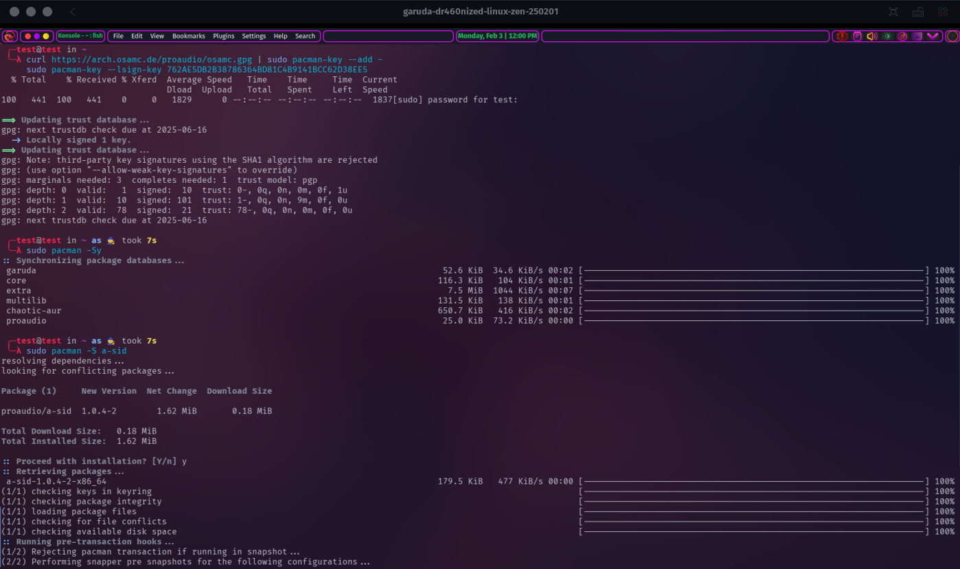

@nepti I’ve tried that several times it always errors on the second step. It will pull the key but errors trying to sign it.
which errors?
please post your output?

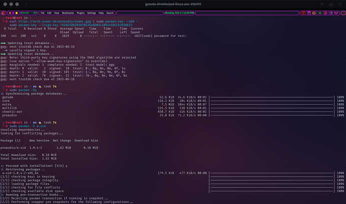

my is looking like this . But ive installed with root account ( i know not recommended ;-P)curl https://arch.osamc.de/proaudio/osamc.gpg | pacman-key --add - pacman-key --lsign-key 762AE5DB2B38786364BD81C4B9141BCC62D38EE5
% Total % Received % Xferd Average Speed Time Time Time Current Dload Upload Total Spent Left Speed 100 441 100 441 0 0 1269 0 --:--:-- --:--:-- --:--:-- 1270 ==> Aktualisiere Trust-Datenbank... gpg: nächste "Trust-DB"-Pflichtüberprüfung am 2025-06-16 -> Locally signed 1 key.
because when i did it was not with thos sudos in front on the github a while ago.=)
I will when I get home from work in 6 hours (and counting :unamused:).
oh yes damn for ya. i have a Bank Holiday here =)
  1. Are you sure you are running pacman with sudo?
it was last year so my pic.
This only works with:
On a user account, pacman-key needs sudo.
i chanced to sudo su ( not recommended) isnt like root? it worked. :upside_down_face:
ive tested you mention.
on a normal user account it starting and blinking a cursor for over 10 minutes ive aborted it for testing it like you say on user account ?
Let’s wait until @mithrandir replies :wink:
I’ll try again when I get home for lunch in about an hour.
Ok, I got it to load the repo but now it won’t download the db
 ╭─scott@scott in /etc🔒 as 🧙 took 1m22s
 ╰─λ curl https://arch.osamc.de/proaudio/osamc.gpg | sudo pacman-key --add -
100   441  100   441    0     0     76      0  0:00:05  0:00:05 --:--:--   116
==> Updating trust database...
gpg: next trustdb check due at 2025-06-16
gpg: Note: third-party key signatures using the SHA1 algorithm are rejected
gpg: (use option "--allow-weak-key-signatures" to override)
gpg: marginals needed: 3  completes needed: 1  trust model: pgp
gpg: depth: 0  valid:   1  signed:  10  trust: 0-, 0q, 0n, 0m, 0f, 1u
gpg: depth: 1  valid:  10  signed: 101  trust: 1-, 0q, 0n, 9m, 0f, 0u
gpg: depth: 2  valid:  78  signed:  21  trust: 78-, 0q, 0n, 0m, 0f, 0u
 ╭─scott@scott in /etc🔒 as 🧙 took 6s
 ╰─λ sudo pacman -Sy
 garuda is up to date
 core                                    116.3 KiB  22.1 KiB/s 00:05 [--------------------------------------] 100%
 extra                                     7.5 MiB  1403 KiB/s 00:06 [--------------------------------------] 100%
 multilib                                131.5 KiB  25.0 KiB/s 00:05 [--------------------------------------] 100%
 chaotic-aur                             650.7 KiB  39.4 KiB/s 00:17 [--------------------------------------] 100%
 prodaudio.db failed to download
error: failed retrieving file 'prodaudio.db' from arch.osamc.de : The requested URL returned error: 404
error: failed to synchronize all databases (unexpected error)
 ╭─scott@scott in /etc🔒 as 🧙 took 16s
[🔴] × sudo pacman -S a-sid
warning: database file for 'prodaudio' does not exist (use '-Sy' to download)
error: target not found: a-sid
 ╭─scott@scott in /etc🔒 as 🧙 took 0s
[🔴] × sudo pacman -Sy
 core is up to date
 extra is up to date
 multilib is up to date
 chaotic-aur is up to date

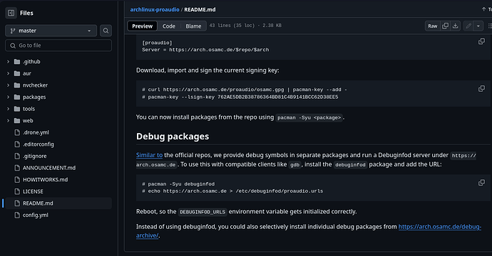

Did you change your pacman.conf correctly and then save it? Relevant section:
# The header [repo-name] is crucial - it must be present and
# uncommented to enable the repo.
[garuda]
Include = /etc/pacman.d/chaotic-mirrorlist
[core]
Include = /etc/pacman.d/mirrorlist
[extra]
[multilib]
[chaotic-aur]
[proaudio]
# An example of a custom package repository.  See the pacman manpage for
# tips on creating your own repositories.
#[custom]
#SigLevel = Optional TrustAll
#Server = file:///home/custompkgs
If so, reboot and just run
garuda-update
again.
gotta love spelling mistakes! I fixed a typo and it worked.
Where, in the pacman.conf ?
Yea. [prodaudio] instead of [proaudio]
Once the new build comes out I’m switching my main os to it.
Yea. Copying a block of code and pasting it back into the right place without making any spelling mistakes is very difficult :wink:
But that wasn’t the cause of this:
The cause was that you didn’t run pacman-key with sudo.
