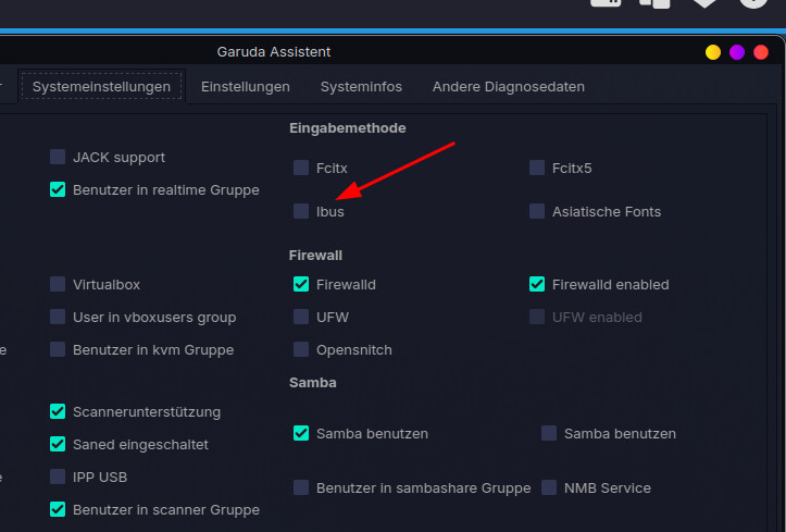

Perhaps with this option about Garuda Assistent ? (I-Bus)
But donÂŽt have the knowledge about this stuff.
may be what you said is true, but still, it is showing some kind of erron
error: target not found: ibus-input-support
Press enter to exit

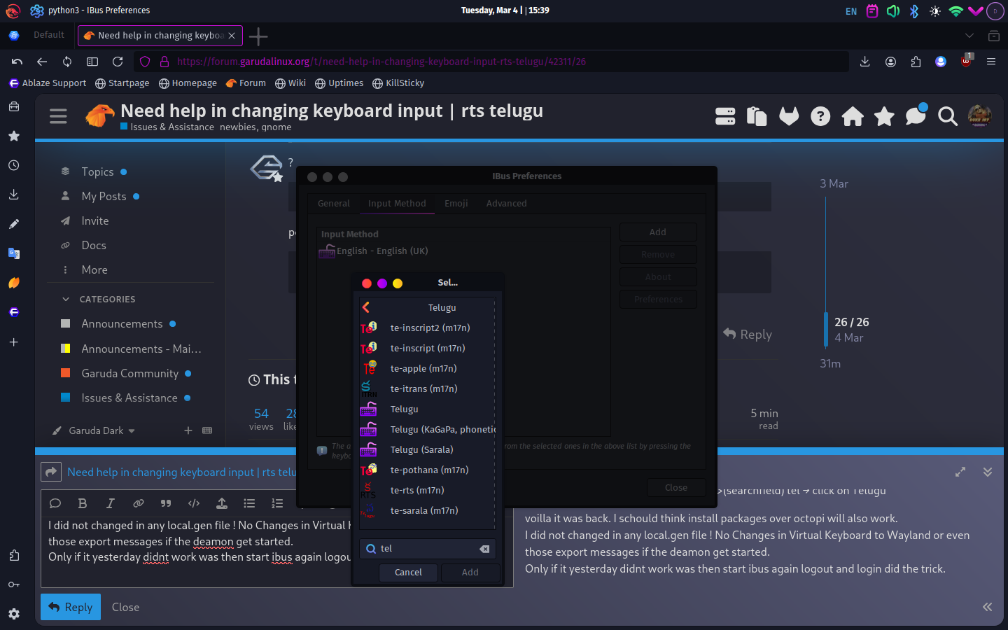

SORRY GUYS!!! MY FAULT!!!
Did installed fresh Garuda KDE Dr460nized Official iso and updated it and reboot.
  1. Install ibus over Terminal: sudo pacman -S ibus
  2. install m17n-db over Terminal: sudo pacman -S m17n-db
  3. Install m17n-lib over Terminal: sudo pacman -S m17n-lib
  4. Make and Install from git:git clone https://aur.archlinux.org/ibus-m17n.git chance to folder cd ibus-m17n/ and makepkg -i.
  5. Open IBUS Setup:ibus-setup
  6. Click on INPUT METHOD–>ADD–>(searchfield) tel → click on Telugu
voilla it was back. I schould think install packages over octopi will also work.
I did not changed in any local.gen file ! No Changes in Virtual Keyboard to Wayland or even those export messages if the deamon get started.
Only if it yesterday didnt work was then start ibus again logout and login did the trick.

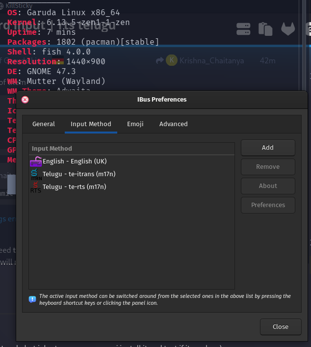

i am using gnome, i can run ibus-setup without using sudo but no language is showing up, after running as super user, i can see the language option popping up but when i add the language, an error message is popping up.
(ibus-setup:34145): dconf-WARNING **: 22:21:39.322: failed to commit changes to dconf: Error spawning command line “dbus-launch --autolaunch=71c9a79afca948e6bcbcbcb018e85e47 --binary-syntax --close-stderr”: Child process exited with code 1
Please, post both of them
[SOLVED] gsettings error - Fedora Forum forums.fedoraforum.org â€ș showthread â€ș 315804-gs
15.10.2017 · You need to run the gsettings command from user account. Sound advice. From a sudo su prompt it will not do anything.
i also run it without sudo but i dont use gnome.may i install it and test if it works.=)
ps. no errors on ibus-setup in the teminal and added the languages too.

Just do not use sudo,
if i do not use sudo, no change is showing up, when i select to choose language, it is showing empty window
