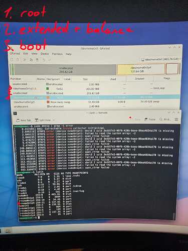

now inam unable to boot at all. It jumped right into grub rescue, and with all possible ls (hdX,Y) it says filesystem not readable. Whilst trying to chroot into the system with a live stick, I couldn’t manage to mount the fs at all. Even in GParted says device 2 is missing…
You didnt remove the fat 32 partition thats located before the garuda btrfs partition. With the boot info did you?
no I didn’t, it still sits there untouched.
This is from the live stick, errors retrieved after trying to mount it
EDIT:
Okay I see what the problem now is. When I tried to add the btrfs device add nvme0n1p2 / it had an error, since before I ran that, I made the partition with the KDE-Partitionmanager. I removed that partition and ran the command again. It worked, why?
After that I ran btrfs balance / as dalto said. And it balanced itself. Now: It did everything somehow on unallocated space. I have no clue how this is even possible, but the system ran fine. After reboot, BOOM grub rescue. Neither in the grub rescue or on the live stick I could even mount the system, since it ‘balanced’ itself over the root partition and the unallocated space.
