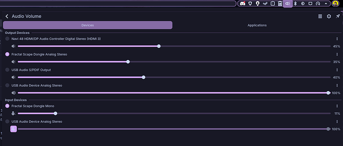

As already mentioned, on many laptops the combo jack is designed in such a way that the built-in speakers (and usually also the integrated microphone) are disabled as soon as headphones or an external microphone are connected. As an alternative to Bluetooth speakers, you can also try to force the built-in speakers as the output device, for example with pavucontrol (pavucontrol also works with pipewire if pipewire-pulse is installed).
You could also purchase an external USB to 3.5 input dongle. That will show up as a separate device in your system.
This is as well honestly a superior solution vs the in build jack.
Cause not sure how about you people, but doesn’t matter what laptop I have, I always hit a terrible noise from the jacks… USB to jack usually makes a huge difference.
