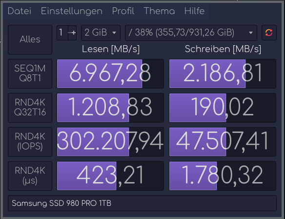

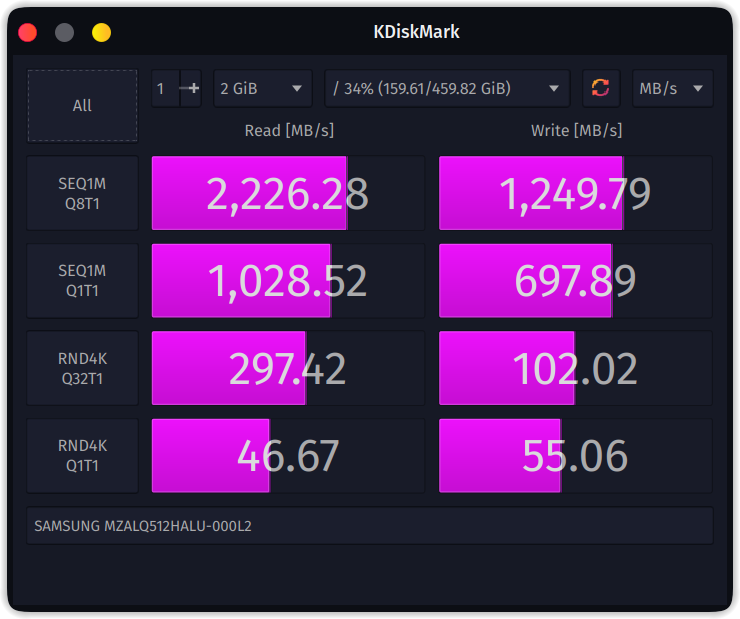

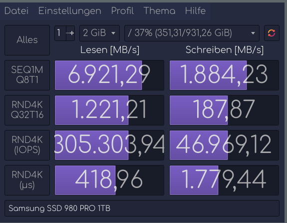

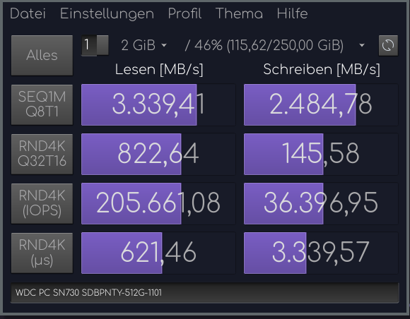

---------> 3.1 Another idea. Can anyone bother to share their KDiskMark result on their System root drive? Preferably M2 drive.

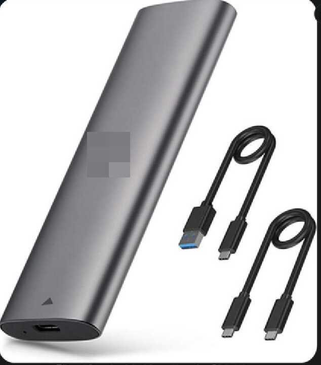

It could also be a heat problem. I have found that with an external NVMe, the performance drops rapidly until I cool it with the help of a small USB-Flower-fan. :slight_smile:
Off topic
Cost ~ € 6, consumption 1 watt. Not nice but effective. :grin:
Fan
ext. Case
L x B x H 11.4 x 3.8 x 1.2 cm
Used to back up all my data from my home server.
Always on hand in case the place burns down or a flood washes everything away.
I know you asked for M.2 but hey Nvme ain’t bad either.:smile:

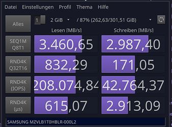

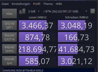

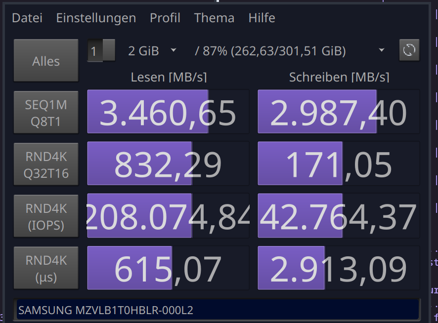

Settings? :slight_smile:
  Kernel: 6.4.7-AMD-znver3 arch: x86_64 bits: 64 compiler: gcc v: 13.1.1
    parameters: BOOT_IMAGE=/@/boot/vmlinuz-linux-amd-znver3
    root=UUID=21e02e96-0ed6-4629-9a39-85ffee7a4359 rw rootflags=subvol=@
    amd_pstate=active ibt=off
  Desktop: i3 v: 4.22 info: i3bar dm: LightDM v: 1.32.0 Distro: Garuda Linux
  Type: Laptop System: LENOVO product: 82MS v: Yoga Slim 7 Pro 14ACH5
    serial: <filter> Chassis: type: 10 v: Yoga Slim 7 Pro 14ACH5
  Mobo: LENOVO model: LNVNB161216 v: SDK0R32862WIN serial: <filter>
    UEFI: LENOVO v: GZCN32WW date: 12/08/2022
  ID-1: BAT0 charge: 34.4 Wh (59.0%) condition: 58.3/61.0 Wh (95.6%)
    volts: 15.9 min: 15.4 model: Sunwoda L19D4PH3 type: Li-poly serial: <filter>
    status: not charging cycles: 70
  Info: model: AMD Ryzen 9 5900HX with Radeon Graphics socket: FP6 bits: 64
    type: MT MCP arch: Zen 3 gen: 4 level: v3 note: check built: 2021-22
    microcode: 0xA50000B
    L3: 16 MiB desc: 1x16 MiB
  Speed (MHz): avg: 1119 high: 3289 min/max: 400/4680 base/boost: 3300/4650
    scaling: driver: amd-pstate-epp governor: performance volts: 1.2 V
    ext-clock: 100 MHz cores: 1: 400 2: 3266 3: 3289 4: 400 5: 400 6: 400
    7: 400 8: 400 9: 400 10: 400 11: 400 12: 400 13: 400 14: 3283 15: 400
    16: 3268 bogomips: 105444
  Device-1: AMD Cezanne [Radeon Vega Series / Radeon Mobile Series]
    vendor: Lenovo driver: amdgpu v: kernel arch: GCN-5 code: Vega
    link-max: gen: 4 speed: 16 GT/s ports: active: eDP-1 empty: DP-1,DP-2
    bus-ID: 03:00.0 chip-ID: 1002:1638 class-ID: 0300 temp: 45.0 C
  Display: x11 server: X.Org v: 21.1.8 driver: X: loaded: amdgpu
    unloaded: modesetting alternate: fbdev,vesa dri: radeonsi gpu: amdgpu
    display-ID: :0 screens: 1
  Screen-1: 0 s-res: 2880x1800 s-dpi: 96 s-size: 762x476mm (30.00x18.74")
    s-diag: 898mm (35.37")
  Monitor-1: eDP-1 mapped: eDP model-id: CSO 0x1402 built: 2020
    res: 2880x1800 hz: 90 dpi: 242 gamma: 1.2 size: 302x188mm (11.89x7.4")
    diag: 356mm (14") ratio: 16:10 modes: max: 2880x1800 min: 640x480
  API: OpenGL v: 4.6 Mesa 23.1.5 renderer: AMD Radeon Graphics (renoir LLVM
    15.0.7 DRM 3.52 6.4.7-AMD-znver3) direct-render: Yes
    link-max: gen: 4 speed: 16 GT/s bus-ID: 03:00.1 chip-ID: 1002:1637
    snd_acp_pci pcie: gen: 3 speed: 8 GT/s lanes: 16 link-max: gen: 4
    speed: 16 GT/s bus-ID: 03:00.5 chip-ID: 1022:15e2 class-ID: 0480
    speed: 16 GT/s bus-ID: 03:00.6 chip-ID: 1022:15e3 class-ID: 0403
  API: ALSA v: k6.4.7-AMD-znver3 status: kernel-api tools: N/A
  Server-1: PipeWire v: 0.3.76 status: n/a (root, process) with:
  Device-1: Realtek RTL8852AE 802.11ax PCIe Wireless Network Adapter
    vendor: Lenovo driver: rtw89_8852ae v: N/A modules: rtw_8852ae pcie: gen: 1
    speed: 2.5 GT/s lanes: 1 port: 2000 bus-ID: 01:00.0 chip-ID: 10ec:8852
    class-ID: 0280
    speed: 12 Mb/s lanes: 1 mode: 1.1 bus-ID: 3-4:2 chip-ID: 0bda:4852
  Report: bt-adapter ID: hci0 rfk-id: 3 state: up address: <filter>
  Local Storage: total: 953.87 GiB used: 262.66 GiB (27.5%)
    model: MZVLB1T0HBLR-000L2 size: 953.87 GiB block-size: physical: 512 B
    fw-rev: 3L1QEXF7 temp: 39.9 C scheme: GPT
  ID-1: / raw-size: 301.51 GiB size: 301.51 GiB (100.00%)
    used: 262.63 GiB (87.1%) fs: btrfs block-size: 4096 B dev: /dev/nvme0n1p7
    maj-min: 259:7

The real solution was ---> Erase the drive of all partitions, then reinstall Garuda and just use the default partition option ---> Use Entire Drive. I swapped 2 flies at one with this cause I wanted a bigger system partition.
Great, now I don't need another Nvme drive.
Results.
Screenshot_20230806_143540
Guru3d SSD benchmark results as comparison. Similar Nvme M.2 drives here, some PCI-E Gen4. The drive is behaving as it should. (CrystalDisk mark has the same tests and layout) My RND4k Q1T1 results ranged from 46 to 60 which is to be expected.
