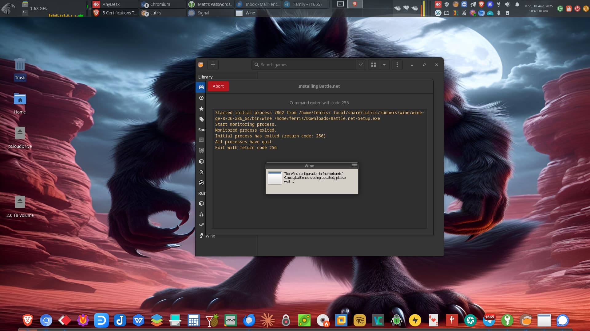

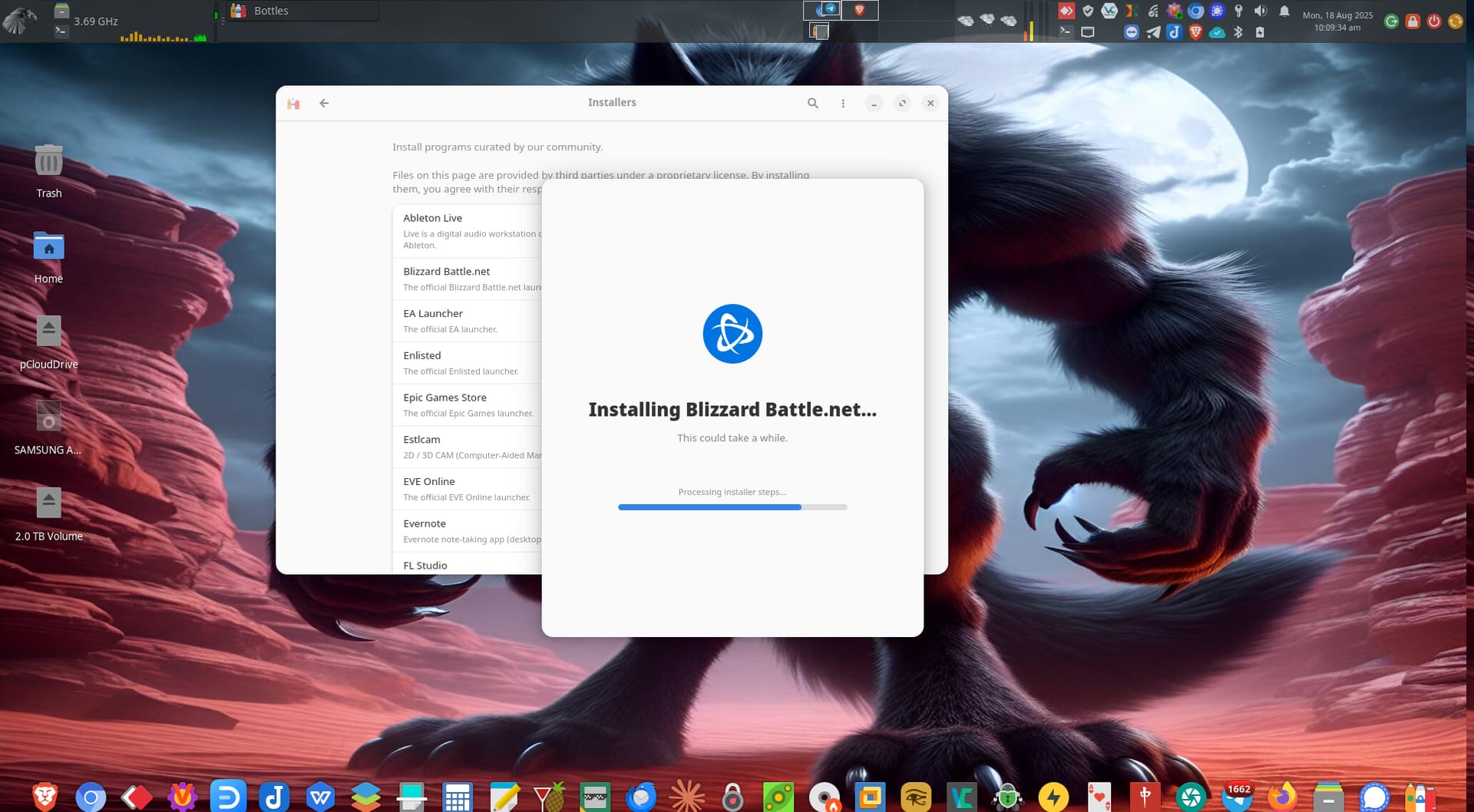

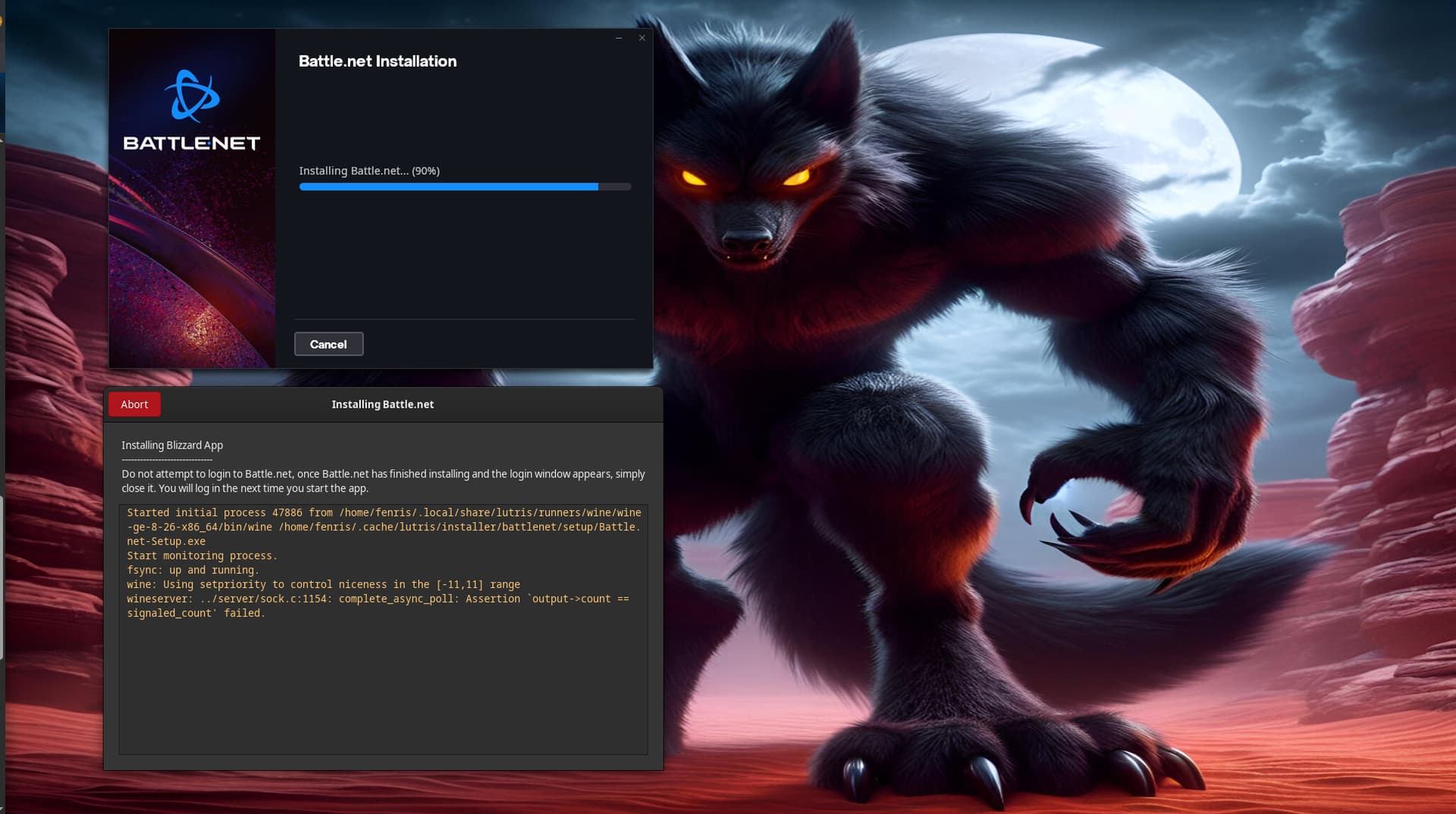

I’m thinking WINE is somehow not updating properly in the background causing Lutris and Bottles to both get jammed when trying to install Battle.net. This is odd to me, cause the Blizzard program is the one program that seems to function the best no matter what I do with Linux.
This is what I see…
I left the bottles one going all night just cause it tole me that “this could take awhile”…I gave it 24 hours, I don’t know how much time it needs :thinking:
Any ideas? Because running games in a virtual machine really leaves my system sluggish :smiling_face_with_sunglasses:

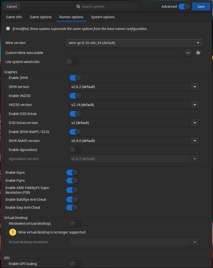

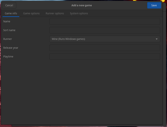

I can tell you how I did it.
Install wine-tkg-staging-bin (AUR).
Download the script from lutris.net to install battle.net.
In Lutris, click the + sign to add a game, select the option via local script and install.

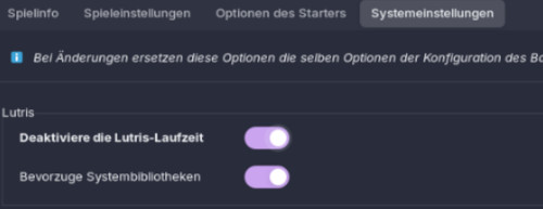

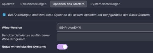

If not available, install version GE-Proton10-10 with protonup-qt (Chaotic AUR) and select it in the Lutris configuration settings in the start options for battle.net.
The client is finicky. Sometimes it doesn’t update itself cause of write errors. Then I switch the options to TKG Staging and then back again.

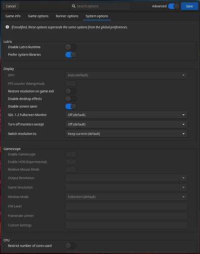

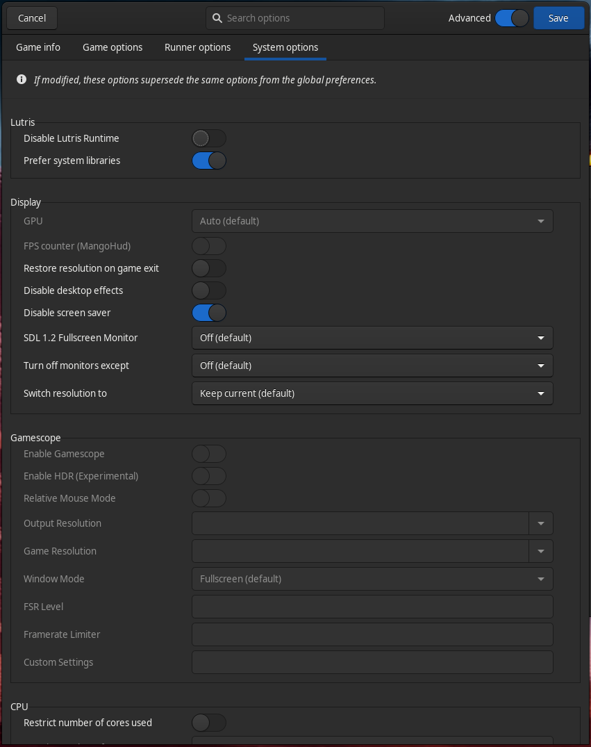

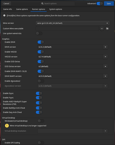

Forgot additional settings I have.

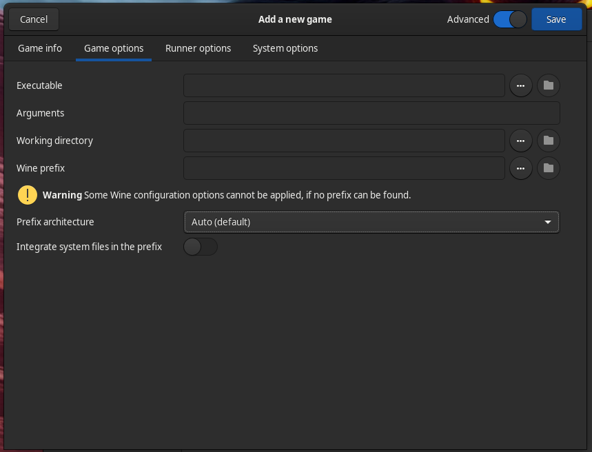

I’m closer after installing wine-tgk-staging-bin and protonup-qt
When I clicked the install script, it didn’t seem to give me options that your showing
Edit:
Ok so I went about it the wrong way…I don’t see the kinds of options that you see…
And I do not know how to implament the script you linked into this setup

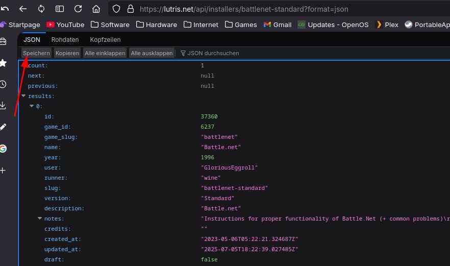

{"count":1,"next":null,"previous":null,"results":[{"id":37360,"game_id":6237,"game_slug":"battlenet","name":"Battle.net","year":1996,"user":"GloriousEggroll","runner":"wine","slug":"battlenet-standard","version":"Standard","description":"Battle.net","notes":"Instructions for proper functionality of Battle.Net (+ common problems)\r\nhttps://github.com/lutris/docs/blob/master/Battle.Net.md","credits":"","created_at":"2023-05-06T05:22:21.324687Z","updated_at":"2025-07-05T18:22:39.027485Z","draft":false,"published":true,"published_by":26956,"rating":"","is_playable":null,"steamid":null,"gogid":null,"gogslug":"","humbleid":"","humblestoreid":"","humblestoreid_real":"","script":{"files":[{"setup":{"filename":"Battle.net-Setup.exe","url":"https://www.battle.net/download/getInstallerForGame?os=win&version=LIVE&gameProgram=BATTLENET_APP"}}],"game":{"arch":"win64","exe":"drive_c/Program Files (x86)/Battle.net/Battle.net Launcher.exe","prefix":"$GAMEDIR"},"installer":[{"task":{"arch":"win64","description":"Creating 64bit Wine prefix.","name":"create_prefix","prefix":"$GAMEDIR"}},{"task":{"arch":"win64","description":"Wine Staging: Enabling DXVA2","key":"backend","name":"set_regedit","path":"HKEY_CURRENT_USER\\Software\\Wine\\DXVA2","prefix":"$GAMEDIR","value":"va"}},{"write_json":{"data":{"Client":{"GameLaunchWindowBehavior":"2","GameSearch":{"BackgroundSearch":"true"},"HardwareAcceleration":"false","Install":{"DownloadLimitNextPatchInBps":"0"},"Sound":{"Enabled":"false"},"Streaming":{"StreamingEnabled":"false"}},"Games":{"s2":{"AdditionalLaunchArguments":"-Displaymode 1"}}},"description":"Disabling Sound/Hardware Acceleration/Streaming in Blizzard App","file":"$GAMEDIR/drive_c/users/$USER/AppData/Roaming/Battle.net/Battle.net.config"}},{"task":{"description":"Installing Blizzard App\n------------------------------\nDo not attempt to login to Battle.net, once Battle.net has finished installing and the login window appears, simply close it. You will log in the next time you start the app.","executable":"setup","name":"wineexec","prefix":"$GAMEDIR"}},{"task":{"name":"winekill","prefix":"$GAMEDIR"}}],"system":{"env":{"DXVK_HUD":"compiler","DXVK_STATE_CACHE_PATH":"$GAMEDIR","STAGING_SHARED_MEMORY":1,"__GL_SHADER_DISK_CACHE":1,"__GL_SHADER_DISK_CACHE_PATH":"$GAMEDIR","__GL_SHADER_DISK_CACHE_SKIP_CLEANUP":1},"exclude_processes":"Agent.exe \"Battle.net Helper.exe\""},"wine":{"battleye":false,"eac":false,"fsr":false,"overrides":{"locationapi":"d"}}},"content":"files:\n- setup:\n    filename: Battle.net-Setup.exe\n    url: https://www.battle.net/download/getInstallerForGame?os=win&version=LIVE&gameProgram=BATTLENET_APP\ngame:\n  arch: win64\n  exe: drive_c/Program Files (x86)/Battle.net/Battle.net Launcher.exe\n  prefix: $GAMEDIR\ninstaller:\n- task:\n    arch: win64\n    description: Creating 64bit Wine prefix.\n    name: create_prefix\n    prefix: $GAMEDIR\n- task:\n    arch: win64\n    description: 'Wine Staging: Enabling DXVA2'\n    key: backend\n    name: set_regedit\n    path: HKEY_CURRENT_USER\\Software\\Wine\\DXVA2\n    prefix: $GAMEDIR\n    value: va\n- write_json:\n    data:\n      Client:\n        GameLaunchWindowBehavior: '2'\n        GameSearch:\n          BackgroundSearch: 'true'\n        HardwareAcceleration: 'false'\n        Install:\n          DownloadLimitNextPatchInBps: '0'\n        Sound:\n          Enabled: 'false'\n        Streaming:\n          StreamingEnabled: 'false'\n      Games:\n        s2:\n          AdditionalLaunchArguments: -Displaymode 1\n    description: Disabling Sound/Hardware Acceleration/Streaming in Blizzard App\n    file: $GAMEDIR/drive_c/users/$USER/AppData/Roaming/Battle.net/Battle.net.config\n- task:\n    description: 'Installing Blizzard App\n\n      ------------------------------\n\n      Do not attempt to login to Battle.net, once Battle.net has finished installing\n      and the login window appears, simply close it. You will log in the next time\n      you start the app.'\n    executable: setup\n    name: wineexec\n    prefix: $GAMEDIR\n- task:\n    name: winekill\n    prefix: $GAMEDIR\nsystem:\n  env:\n    DXVK_HUD: compiler\n    DXVK_STATE_CACHE_PATH: $GAMEDIR\n    STAGING_SHARED_MEMORY: 1\n    __GL_SHADER_DISK_CACHE: 1\n    __GL_SHADER_DISK_CACHE_PATH: $GAMEDIR\n    __GL_SHADER_DISK_CACHE_SKIP_CLEANUP: 1\n  exclude_processes: Agent.exe \"Battle.net Helper.exe\"\nwine:\n  battleye: false\n  eac: false\n  fsr: false\n  overrides:\n    locationapi: d\n","discord_id":null}]}
Which browser you use ? With Google-chrome ? sorry..use firedragon or firefox
click on save to downlad the file (filename = battlenet-standard.json then →
→ etc

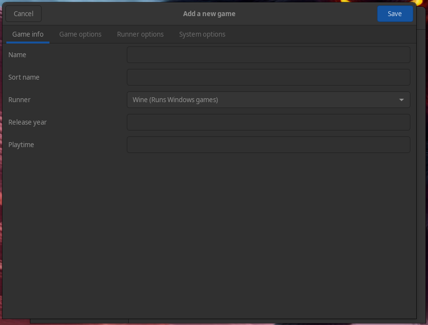

The method you used in the first two screenshots assumes that Battle.net is/was already installed. After reinstalling the OS, you can use this method if you had backed up the Games folder. If this is the case, select a name in the first image above and navigate to your battlenet folder in the second image under “Executable” and click battlenet.exe. Not the launcher!
In protonup-qt, you can download different proton versions. Simply installing protonup-qt does not change anything. Start it and click through the two drop-down menus.

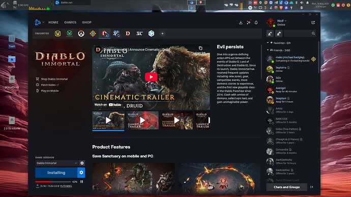

Now to be fair, I did kind of getting it working following the tkg and proton settings you suggested.

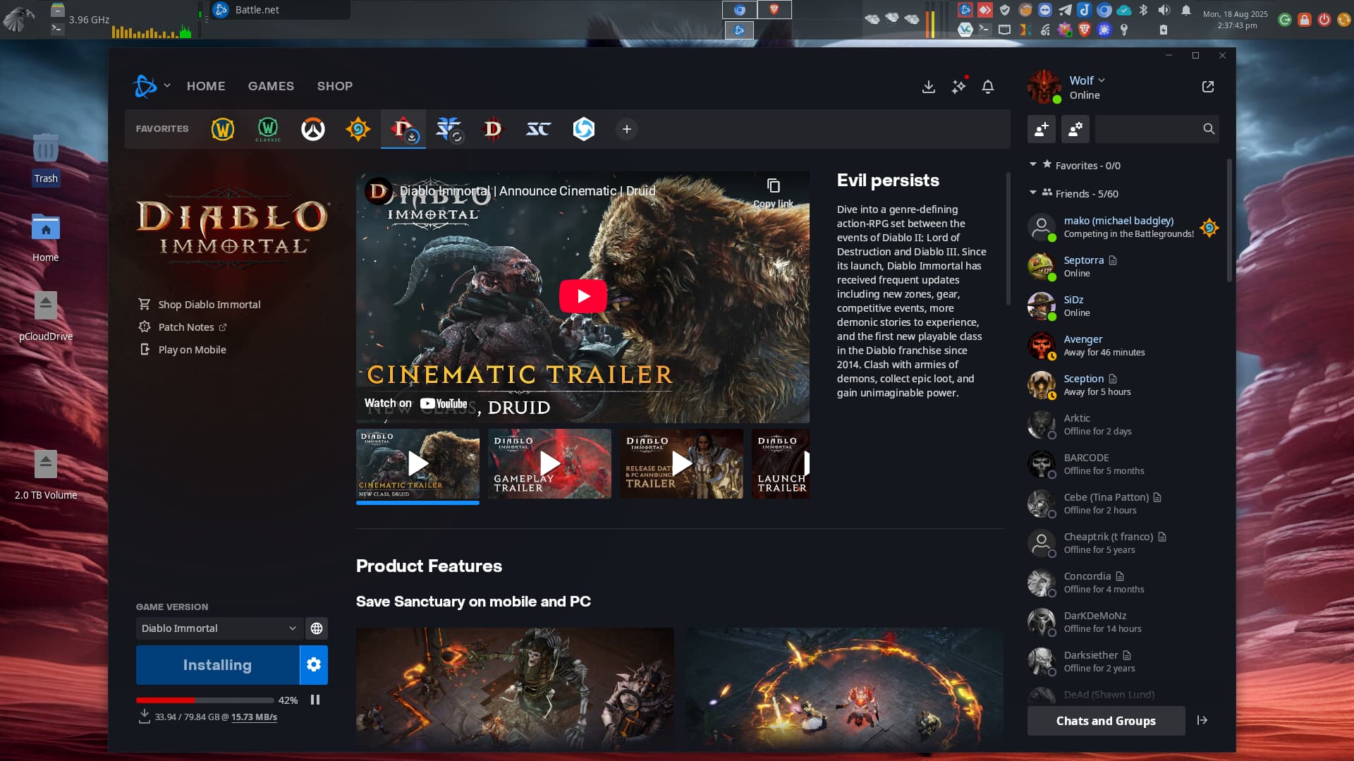

It took a lot of going into the task manager and killing the wineservice entries before this screen could show up. I don’t know if I would consider that a green checked solution as to fixed. So it works right now, but if I restart my computer like 10 times, and another trillion updates come out for Garuda…is this going to get jammed up and not run again? I don’t know

Personally I think Bottles is easier to use then Lutris, but now that I got battle.net working. I guess I can now go back to Lutris for some things. I still can’t make GOG things work properly but at least we got a good start to some of these updates.
