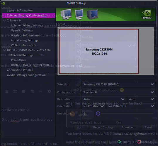

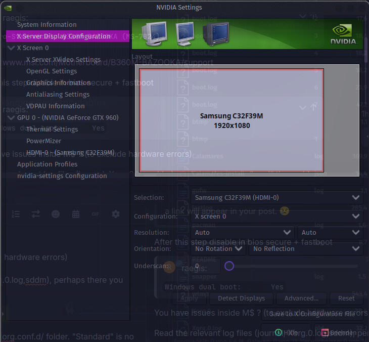

inside X11 session run nvidia-settings → save the settings. (.nvidia-settings.rc)
or about inside this tab
save the file inside your home folder (do not change the name xorg.conf)
copy (with root privileg) to /etc/X11/xorg.conf.d/ folder. “Standard” is no config there, but sometimes x11 need this file for the settings. (gpu+display)
