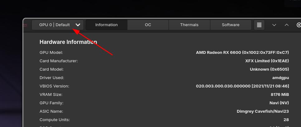

you have to enable the demon there’s a button to do it. should be in the software tab. its a gui tool so no need for sudo
Already did sudo systemctl enable --now lactd
https://i.imgur.com/DdMu04u.png
https://i.imgur.com/KDJseuu.png
Your pictures: lact show your igpu (amd) and not your dgpu (nvidia)
and the fan is not physical connected, of course that’s the cpu fan.
With
  • lact cli list-gpus
    or
  • lact cli info
    you see gpu information.
    If you don´t see about this your dgpu than fan monitoring or control might not be available on some laptops (own message from the lact devs)
But perhaps reboot can also resolve this. (not shure)
And you can switch if you click there
No function about lact try with coolercontrol (sensors must running then) or corectl.
Self, no knowledge about both.
Nice catch, thanks. I always forget that this CPU as that. Looks to be working perfectly now.
