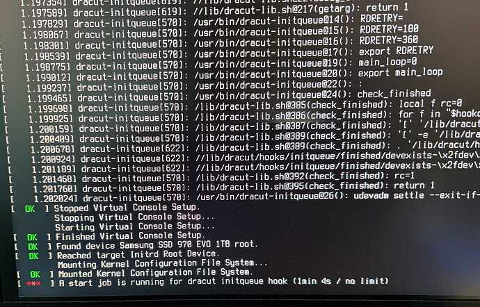

Can you please remove the quiet and loglevel=3 parameters from the kernel cmdline and add rd.debug to it instead?
Afterward, sudo update-grub and then reboot. Then show us where it gets stuck, a picture would work.
They have already been removed. I’ll add rd.debug.

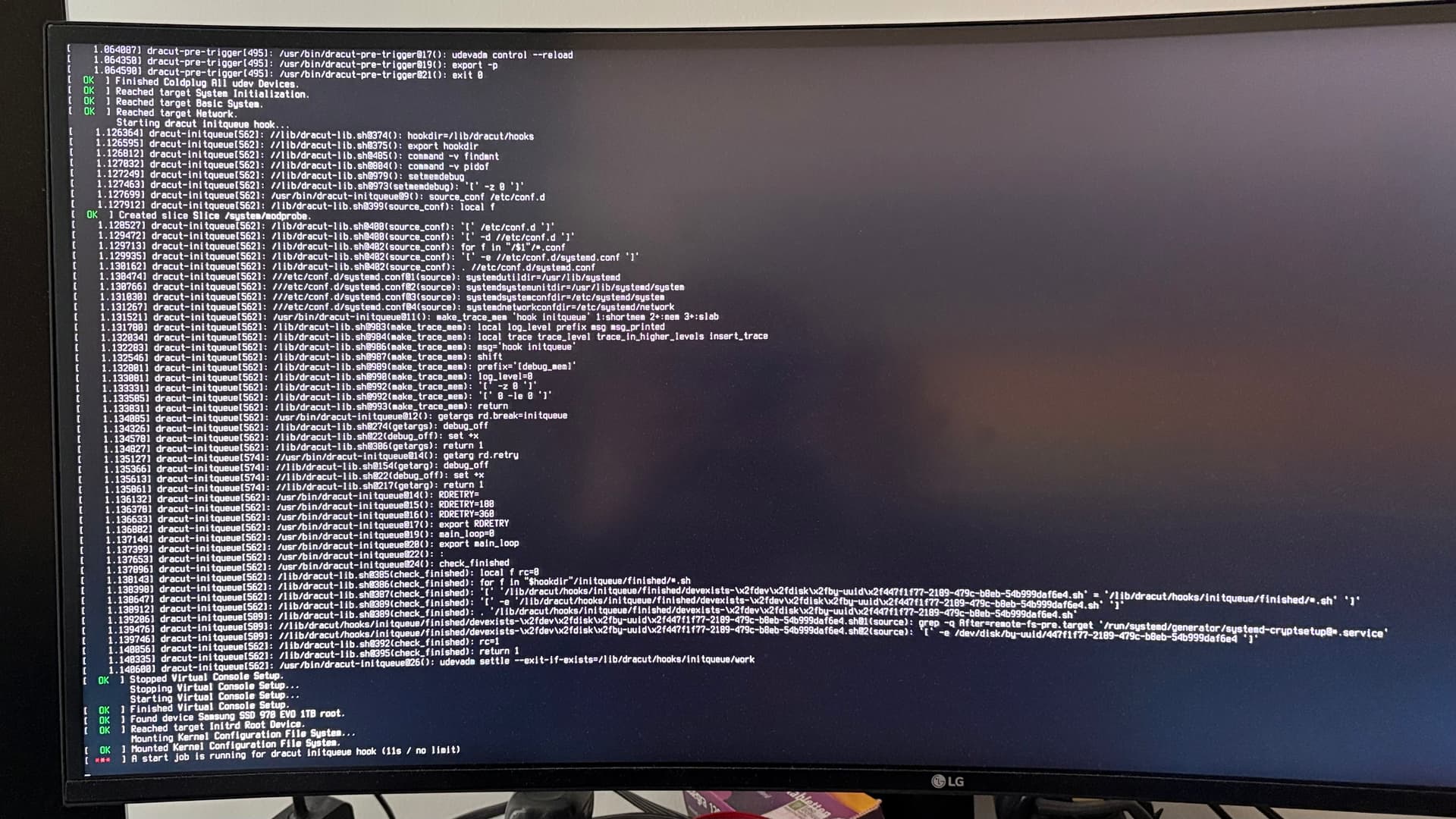

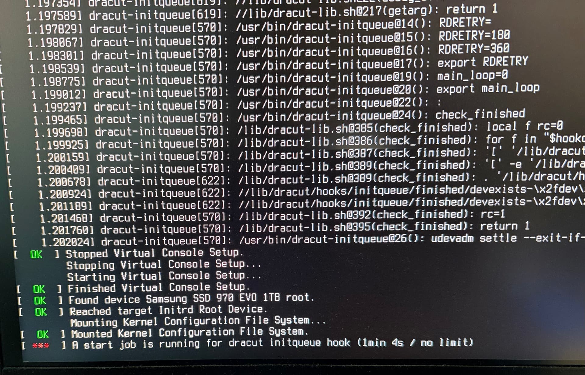

Edit: bootup pictures:
Heya. We need to be able to see the whole text, please. Cut off parts of the logs are not useful for diagnosis.
Okay, here‘s a new picture. As before the last line ran up to 1 min 4 seconds.
