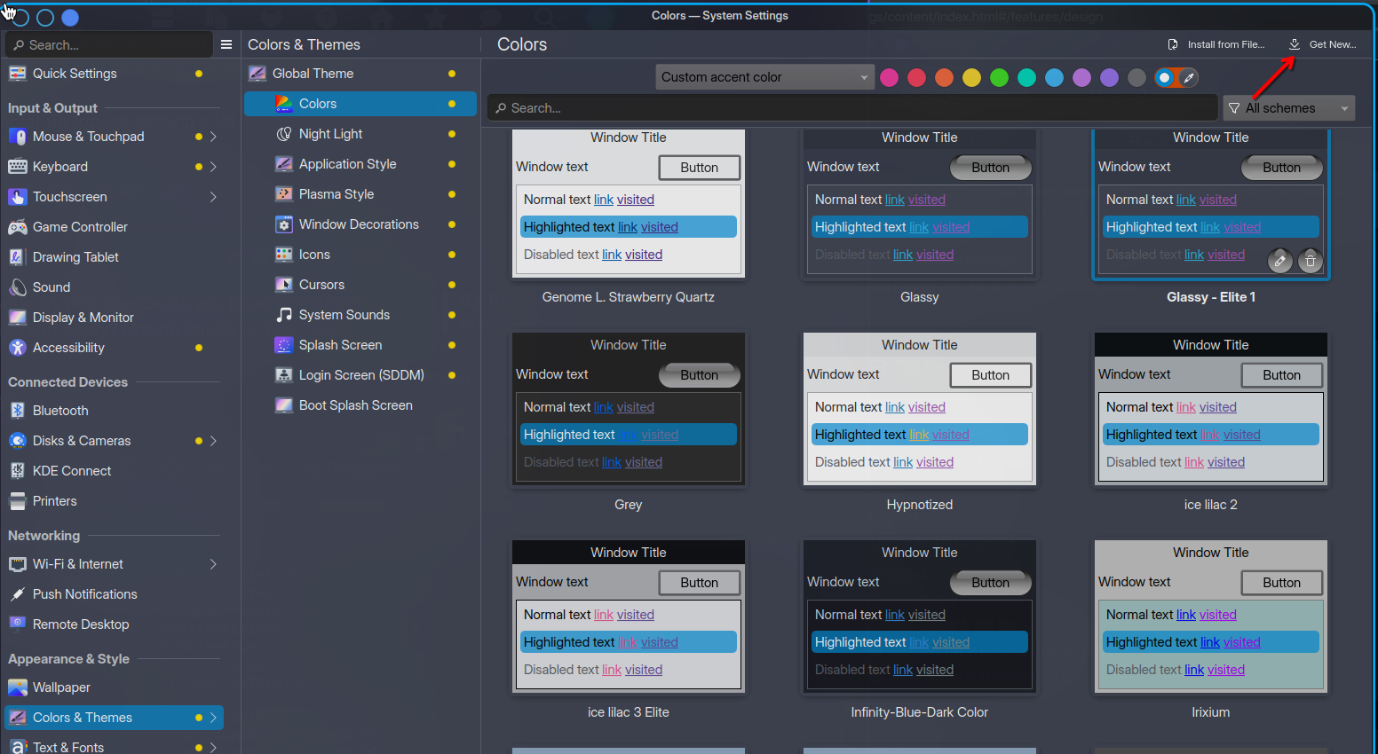

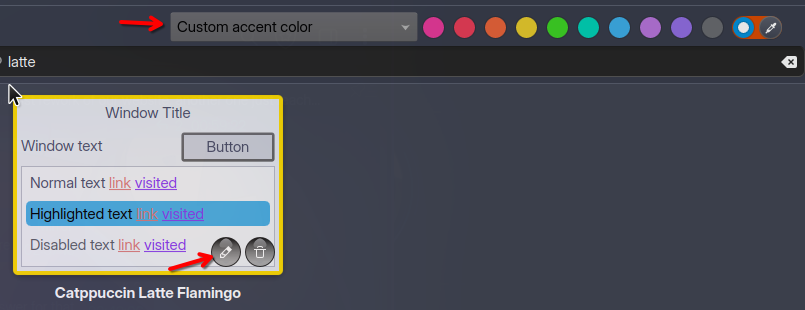

Grab this here Catppuccin Latte Colors - pling.com
Run paru ocs-url in terminal first install it then on the website click install. You can just download it and manually place it but its a time waster.
and change the accent color to taste.

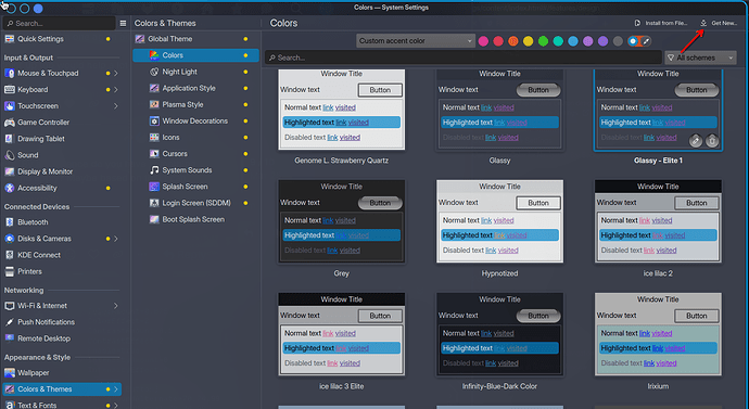

go to settings → colors & themes → colors and pick it there. don’t forget to hit apply
I installed latte colors from the ocs-url. Now I see only this color, applying it breaks the current theme (still broken after a restart)

For example, after applying that color:
You can tweak the parts you don’t like here.

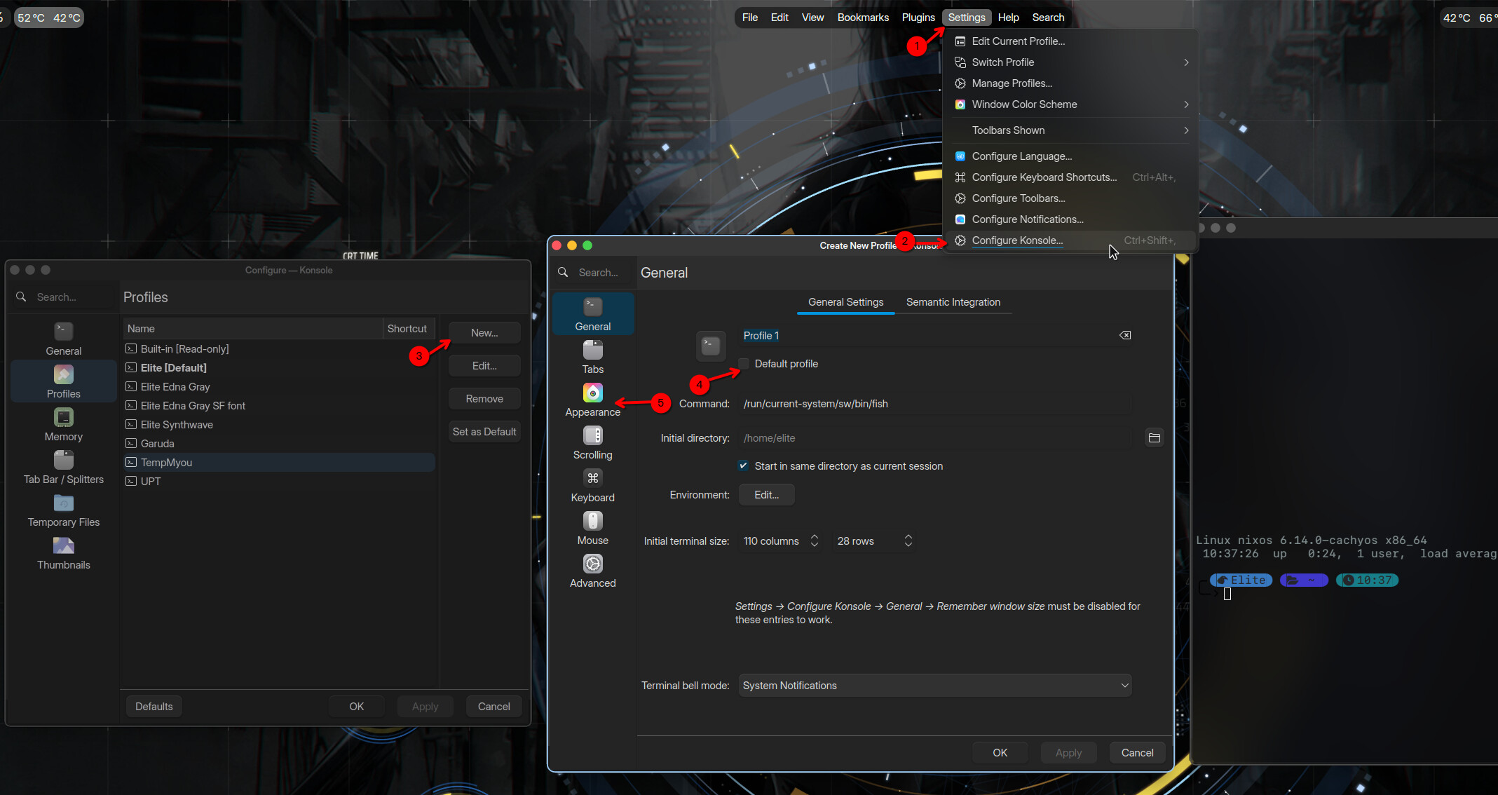

For the konsole and other mokka things most of where to get them are here Release Notes and Migration | Garuda Linux wiki as stated above but mainly on the gitlab
If you just want to theme it like the rest of your system here is how,
*Note your global menu at the top will likely be to the left.

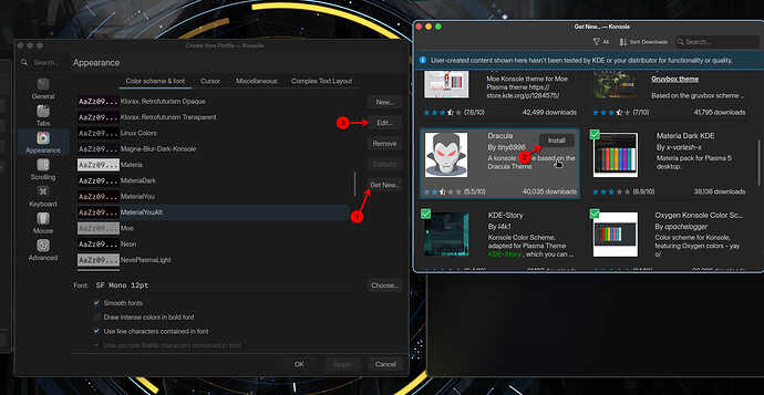

After making a new profile, setting it to default and clicking Appearance. You can go to “get new” and grab one or if you manually put one in its folder, it will be in its list on a fresh start of the app.
