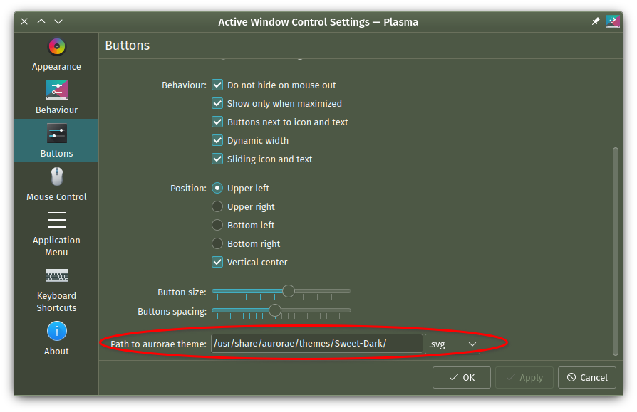

I was testing Active Window Control on kde-git and that space was left blank if not using standard white arrow buttons. It's possible I didn't use the right setting, though, which is why I will try again.
I am on 5.26.90. This is the setting for changing the look:

I added Active Window Control and enabled borderless maximized again

I configured AWC to show for maximized windows only and when I hover on Store Library etc. Plasma treats the context menu as a seperate window and focuses to it. When this happens AWC disappears because the so-called "window" is not maximized.
Saw that you have it set that way.
Shouldn't be an issue unless there is a maximized Steam window then.
