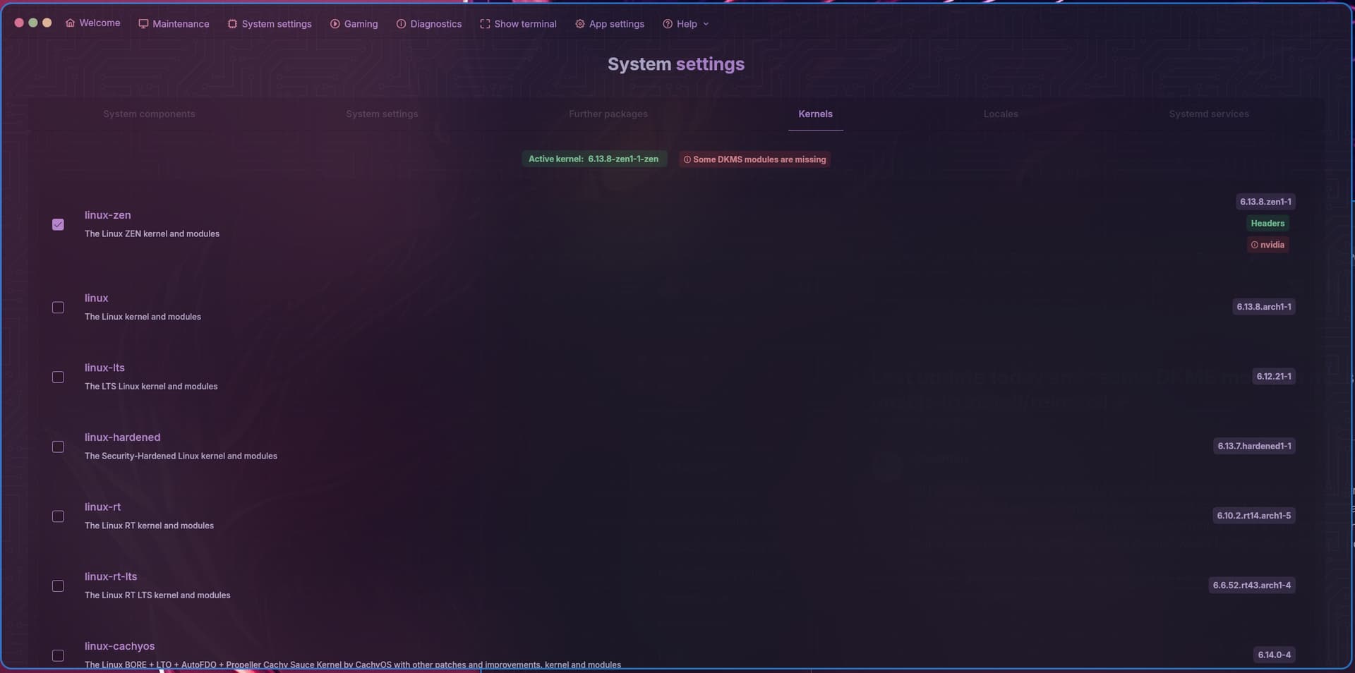

Last update today and "some DKMS modules missing" and unable to install/reinstall
Hi! I updated, rebooted, and start to play but I observed the game are running very bad. I’ve checked and find some problems with DKMS kernel modules and nVidia driver. I’m not able to reinstall the modules nor the nVidia driver. I’ve tried the Garuda Setup manager but “checking for nvidia drivers” would tekes forever without “finding” one.
I’m out of any other “knowing” what should I do, please help!

hi djbashtan,
did you try to click on the red nvidia chip and execute it ?
or try install over terminal
sudo pacman -S nvidia-dkms
Screenshot_04-Apr_15-16-30_26570
or over pacseek nvidia-dkms search :wink:
ps you also can update your bios :wink:

Hi! Thanks! I’ve tried sudo pacman -S nvidia-dkms but ends on “Error! Installation aborted”
As for or over “pacseek nvidia-dkms search” I don’t know how to do it.
As for updating bios I prefer not too. My Garuda was working around 2 weeks PERFECT! My games were also perfect, everything was perfect until today. Whit my actual “old” bios. I prefer not put my hands inside there :innocent: since I’m a such a IT absolute ignorant :innocent:
it look like its already installed
type pacseek in terminal if its not installed you can install it with the same sudo pacman -S pacseek
but maybe its a rani issue? you can try to install rani-git instead of it.
did you reboot again and checked maybe afterwards its no error anymore.
wait for @nepti =)

It is not helpful to post a screenshot of rani - what we need are logs. The update process is displayed in the terminal and it is always useful to keep an eye on this or scroll up after the update to check for possible error messages.

Now I have the LTS kernel and everything seems to be ok! So far no issue’s shown!
Today (2025.04.05) I’ve tried to reinstall Zen Kernel back, BUT, when I enable it for install in Rani, right away appears the “nVidia” and “DKMS modules missing” warning message.
When you install the `linux-zen kernel, the dkms modules are also rebuilt - have you rebooted afterwards?
Reboot your system and then:
and the output of:
mhwd-kernel -li
