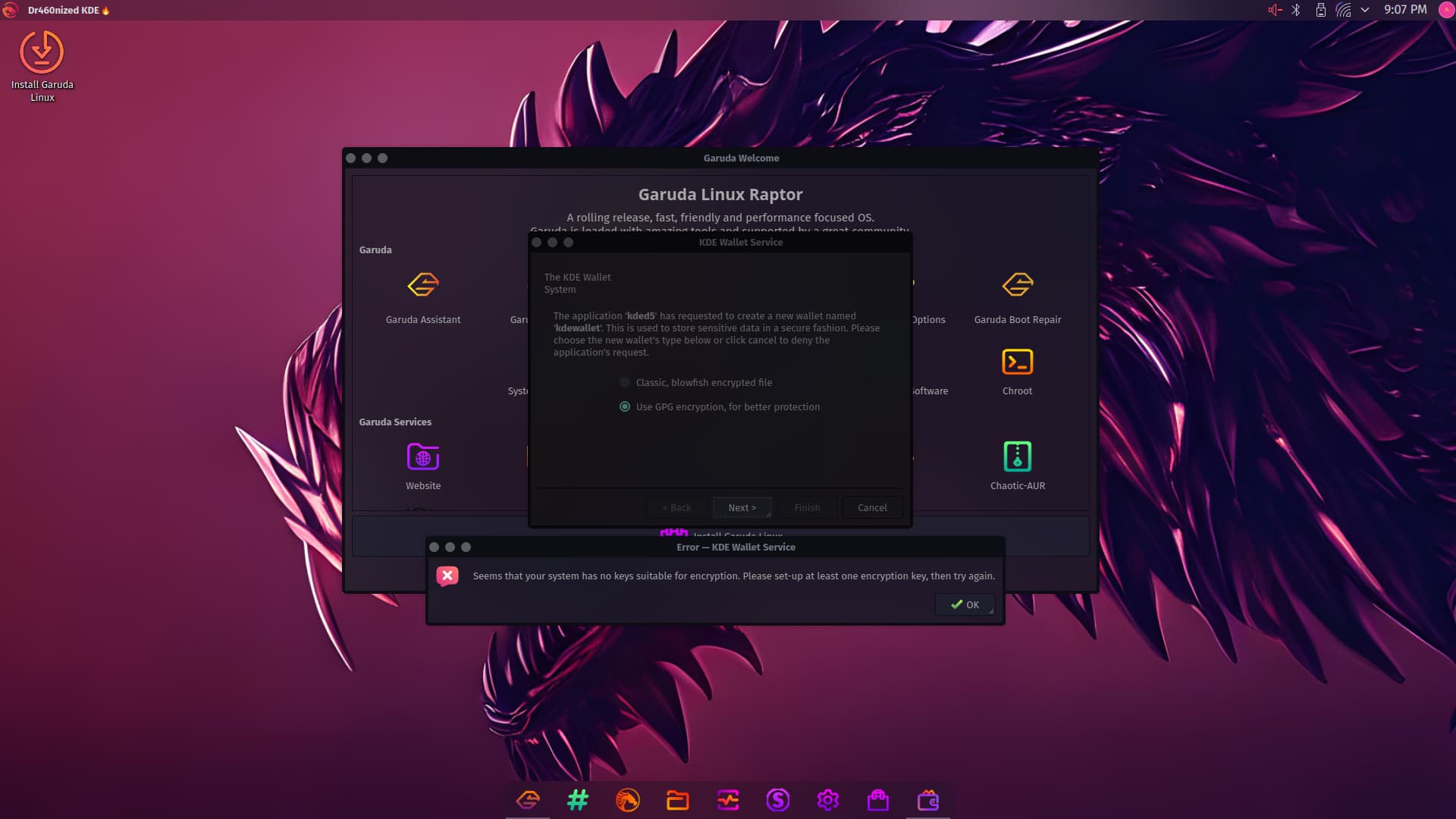

KWallet gave a number of issues from a fresh install of Garuda Linux Raptor Eagle, including:
  1. On connecting to Wifi in the Install Garuda Live ISO, it gives a GPG error about no key available, with no steps ahead

The exact error is as follows:
  1. First, after entering the WiFi password, it asks me whether I want to use classic blowfish encryption or GPG encryption to create a new wallet
  2. If I choose GPG, it tells me "Seems your system has no keys suitable for encryption. Please set-up at least one encryption key, then try again."
This is what happens in issue number 1 in my original post. After that, I tried step number 2, and due to the issues mentioned ahead, I could not get KDEWallet working well with the system.
