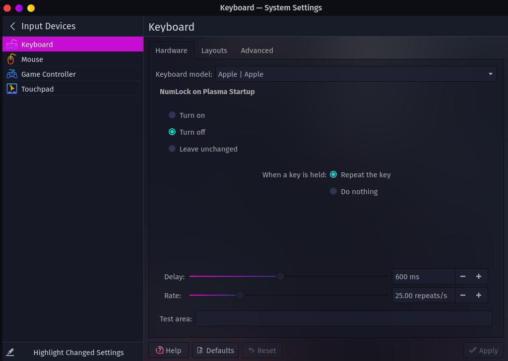

I just switched from manjaro to garuda and I am loving this distro. One thing that is driving me insane is that when I switch my keychron k2 from wire to bluetooth mode there is no valid input. While it is wired it works flawlessly. It worked previously in manjaro. If someone can lend a hand that would be fantastic.

Found the solution. It wasnt what I expected. Turn numlock off in the keyboard section and bluetooth works like a charm.
I mark it solved.
Please, always post details of the hardware as well, you will make it easier for the helpers. Not everyone knows the designations of the bitten fruit company.
Keychron K2 Wireless Mechanical Keyboard (Version 2) has no numpad so software failed, KDE bug :smiley:
I switched the model to the generic keyboard and it was still working. My apologies for not posting more on the hardware details I tried it after seeing someone was having the same issues in an ubuntu post and gave it a shot. Thank you for your help.
