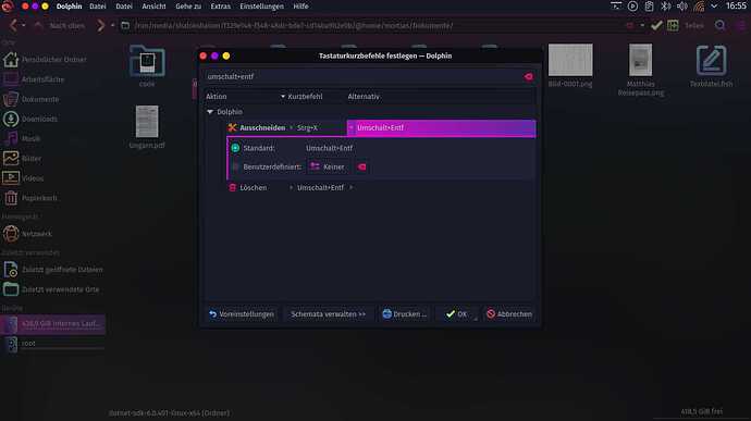

Keybinding for shift+del
For decades now, I used shift+del to delete files without putting them into the bin first.
For some reason, someone (probably at KDE) thought its a good idea to break that, and assigned cut (ctrl+x is obviously not enough for that) as well and that broke both.
Dolphin now tells me, that the keybinding is bound double, and that it cant do anything that way.
Complete fresh install, updated and rebooted.

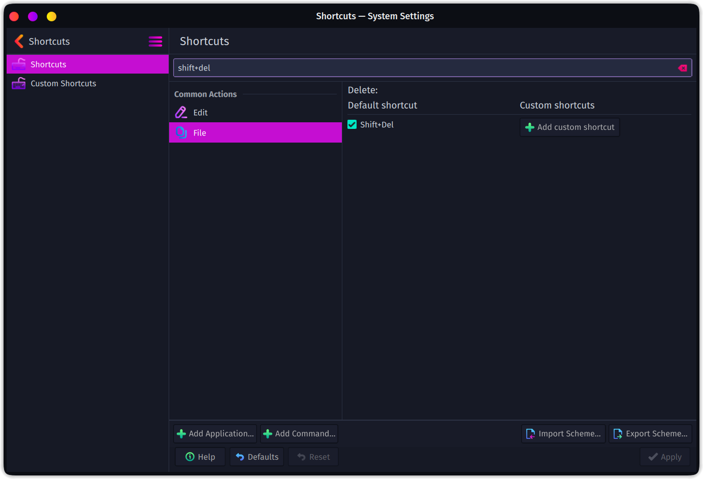

Wait.. You want Shift + Del to perma delete files & folders?
It is doing exactly that on my system.

Thanks a lot you all. Could you see, if the keybinding is applied to both, cut and delete, and report on that?
Maybe its supposed to work this way, and my issue lies beneath, and it just doesn't work because of the handling of the differentiation.
Does it show for you the same as in the screenshot? Or is only one set :slight_smile:

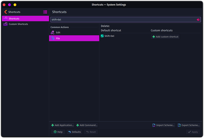

Yes, it is a shortcut conflict. As you can see in my screenshot.
I had updated my system this morning and I still have both cut (ctrl+x) and delete (both just del and shift+del) are working as intended for now.
You can check your kde shortcuts and in the search box type shift+del and it will show you all the shortcuts with that as keybinding. Infact I noticed something strange there.
Maybe this is why you are facing the issue. Though it’s quite strange that I don’t face it. anyway I believe turning off shift+del in edit for cut should be good enough. Or you can turn it off for all then apply and then turn it back on for the intended targets then hit apply again in case it doesn’t work the first time.

You can custom tailor shortcuts. See the screenshot above: Add command.

My very first screenshot shows just that. (Just in German, sorry.)
