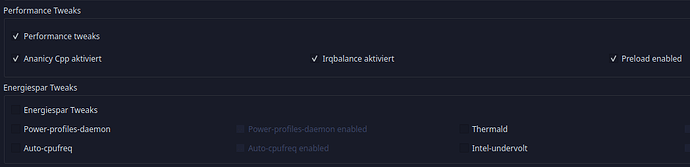

I did activate all the power saving tweaks. But still did not get much a difference. But will the points I mentioned in the original post affect the battery drain?
Did not get what you want to say. But if it is about enabling the power saving tweaks then I did
