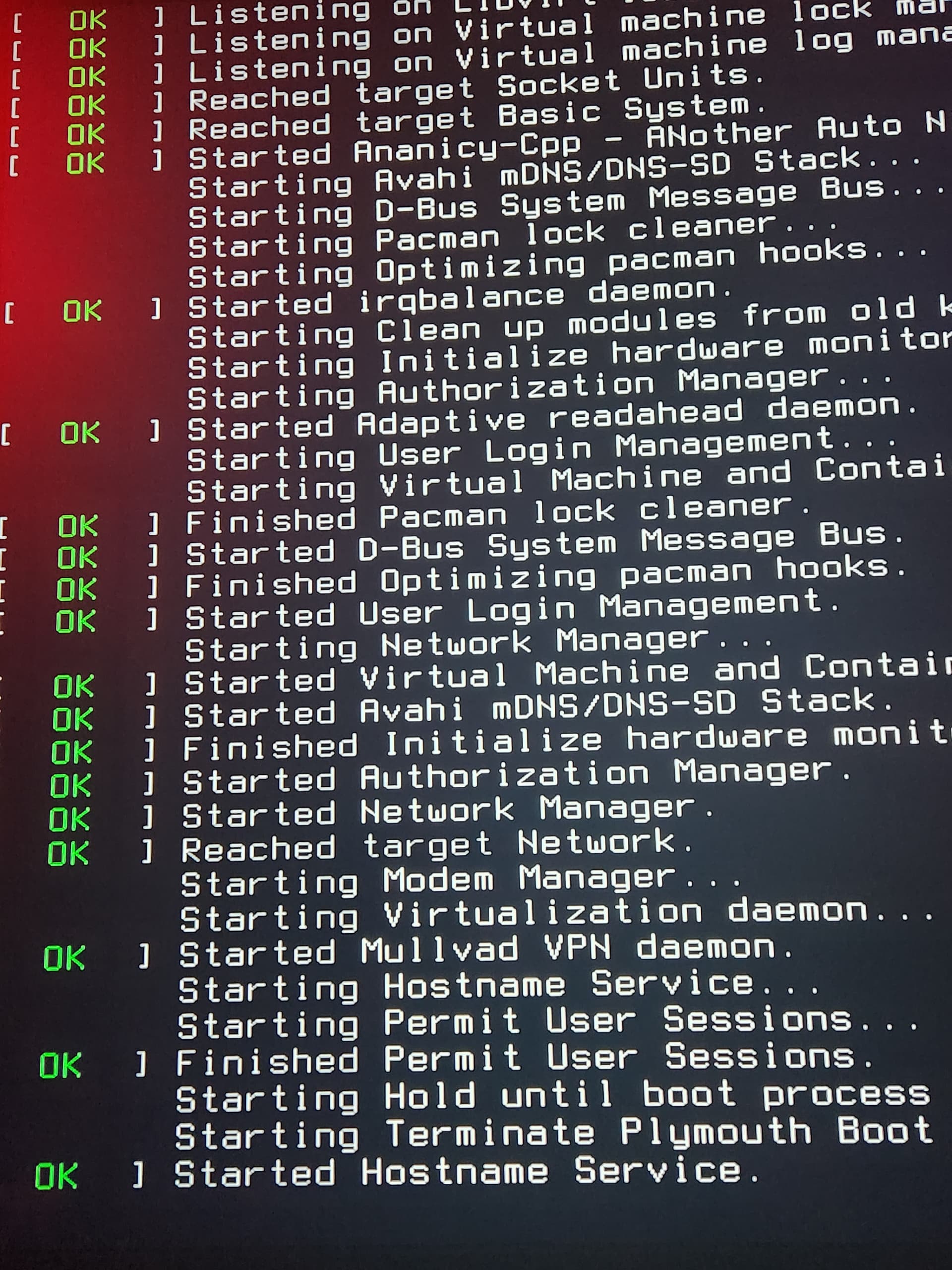

Booting when removing quiet from grub shows that it hangs on
Started Hostname Service
