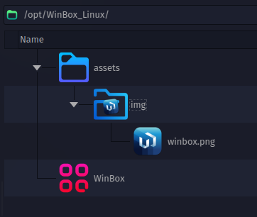

self contained (unzipped):
It seems they might have packaged an icon or something, there is a discussion about icon issue if you look here
EDIT: They also package a .desktop file which on Line 7 points to the icon.
Thanks, but the package icon is working. I realized this after my initial post. But if there was not a packaged version, my question is then how do I get icons to not be the question mark. I noticed the same thing if you do a self contained app setup like Cura (3D Printer Slicer). This shows the question mark icon until launched too (Again, I found the package version after).

This WinBox.desktop file seems to do the trick for me. I can now launch from this and pin the .desktop file to the taskbar and the icon stays!
[Desktop Entry]
Categories=Utility
Comment[en_US]=GUI administration for Mikrotik RouterOS
Comment=GUI administration for Mikrotik RouterOS
Exec=/usr/bin/env --unset=QT_QPA_PLATFORM /opt/WinBox_Linux/WinBox
GenericName[en_US]=
GenericName=
Icon=/opt/WinBox_Linux/assets/img/winbox.png
MimeType=
Name[en_US]=WinBox
Name=WinBox
Path=
PrefersNonDefaultGPU=false
StartupNotify=true
StartupWMClass=WinBox
Terminal=false
TerminalOptions=
Type=Application
Version=1.0
X-KDE-SubstituteUID=false
X-KDE-Username=
Thanks @FGD !!!
