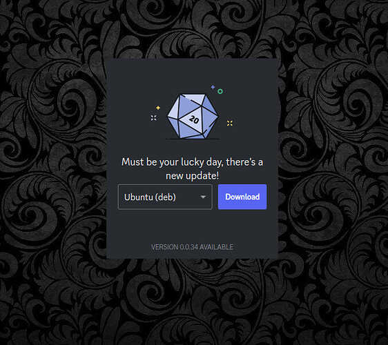

now the question is, how do i go about updating individual packages such that i can still use discord?
discord needed to update in that last round of updates XD

as for the “whatever issue you are having with discord” it’s pretty simple, it looks like this:
Oh wow, it won’t let you get around that or do it another time or something? I don’t use Discord but that seems kind of annoying. :joy:
I get that a lot too. It’s VERY annoying. It won’t let you use it if there is a new version that is out that you don’t have. Even if you update your system on a daily basis, Discord loves to throw that message up at you. And when I try to update to fix it, a lot of the times I have to wait for the packages to become available for the official app.

i installed armcord just now. seems legit so far, already on voice/cam calls. i’ll use that for now till official update happens
