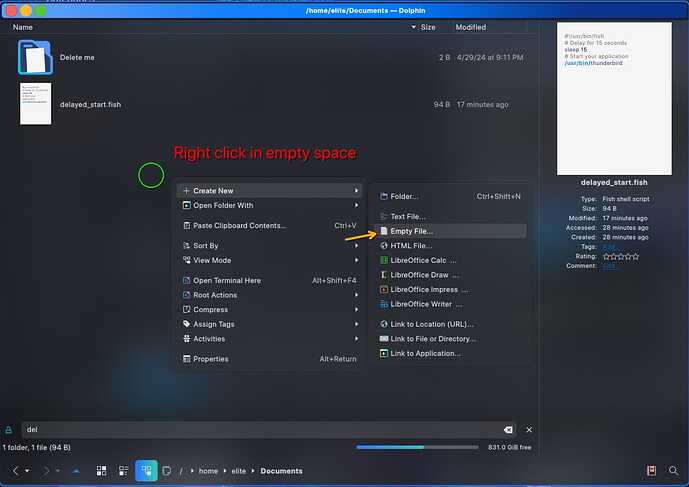

If you use fish shell and are like me and have things you want on a delay for autostart in KDE. Here’s the script so you can make a executable fish file.
- It can be a text file or empty file. Just make sure the name ends in .fish
Then add the text below, where “APP NAME HERE” is you can find it in dolphin or in terminal type which app-name (Example which thunderbird)
Then put it in place of ~/usr/bin/APP NAME HERE

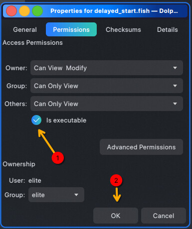

Don’t forget to make it executable after you make it.

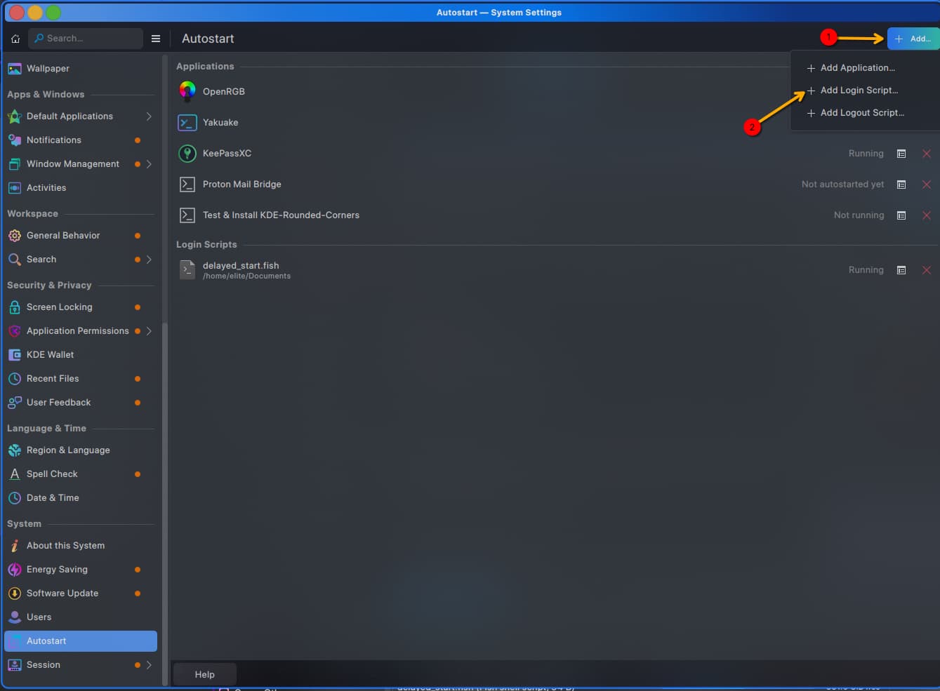

Right click on the file an click properties → permissions
Then just add it to auto start.
