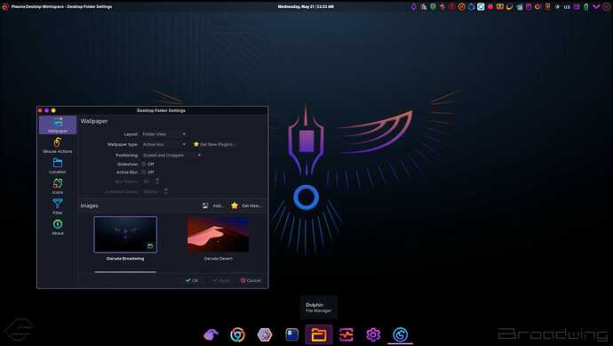

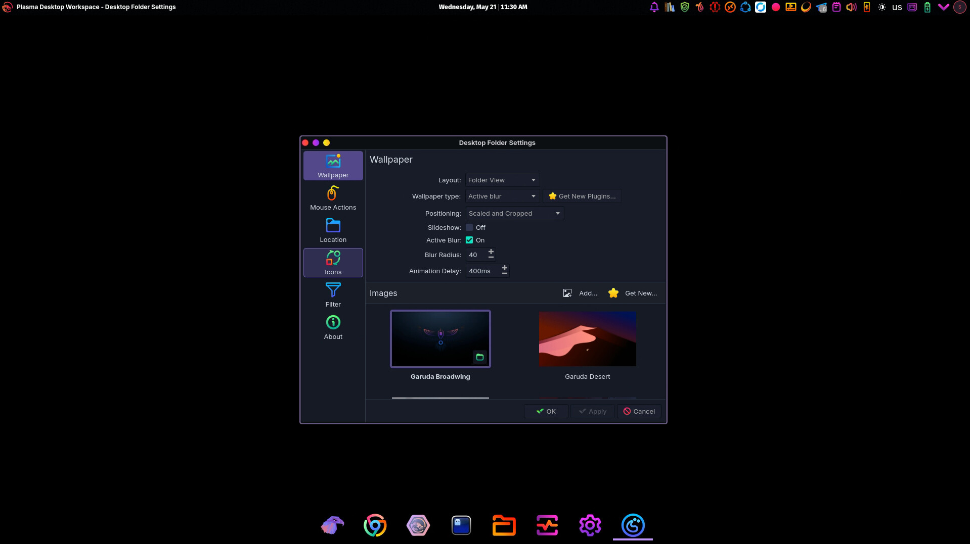

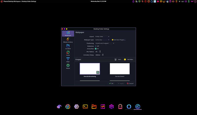

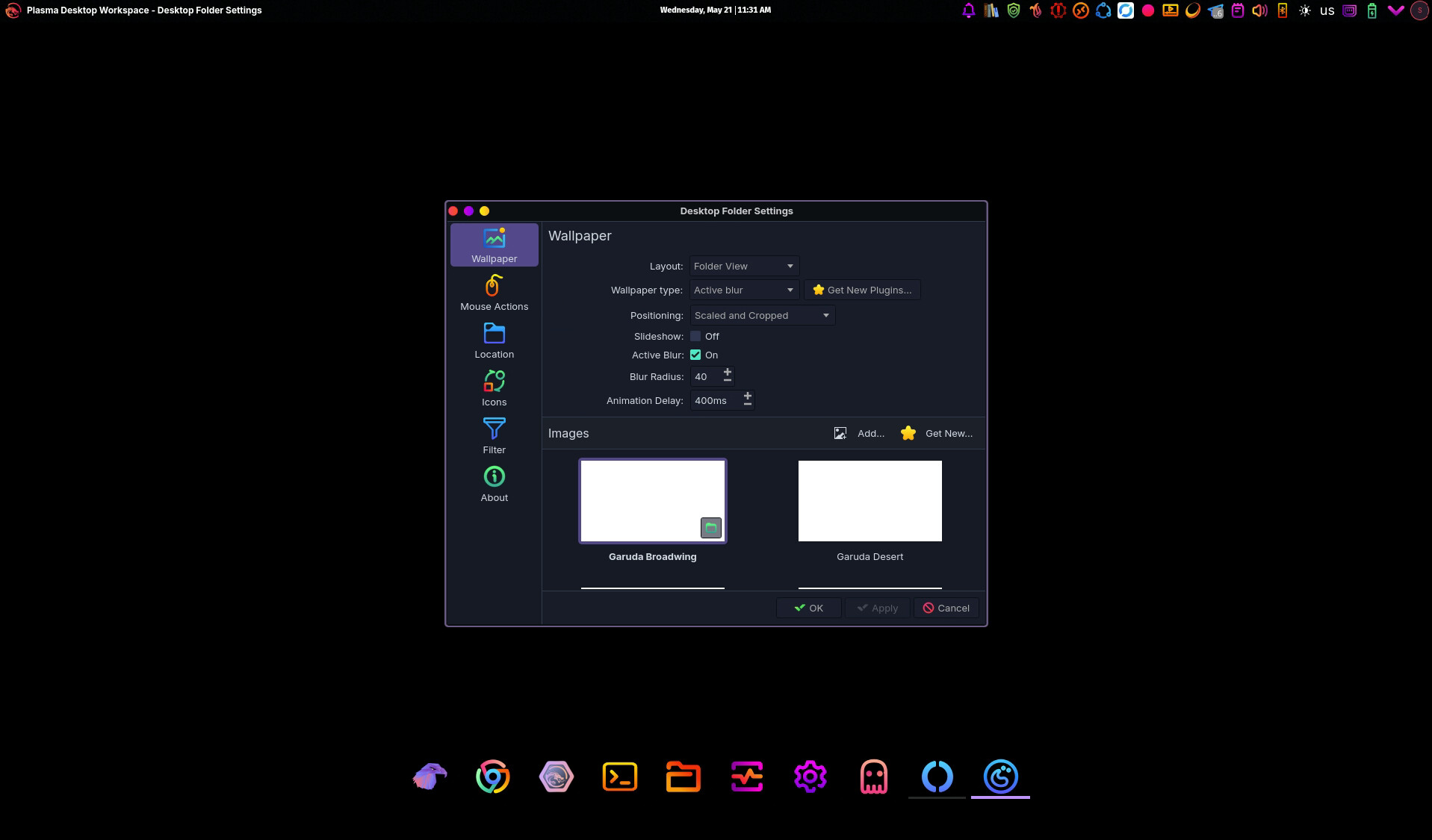

Bizarre thing happened. Rebooted the machine after a regular update, after logging back in, the wallpaper on both monitors (set to Garuda Broadwing) do not appear. The wallpaper is just black on both monitors. When I right-click and select “Desktop and Wallpaper” on the left monitor, it shows the selected image, but the wallpaper is still black. When I do the same on the right, it shows all the images as white boxes, and doesn’t display their thumbnails. See here:
Left monitor:
Right monitor:

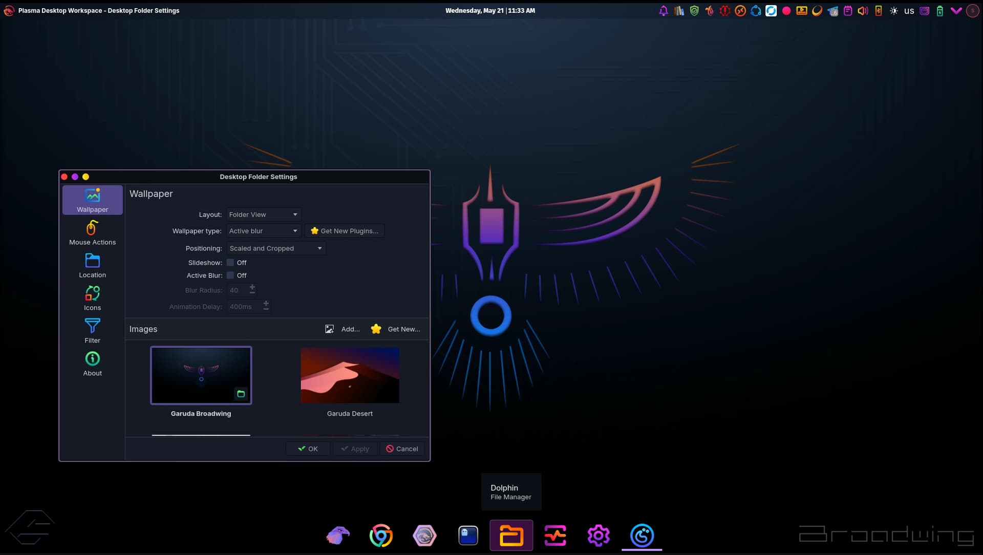

However, when I disable the “active blur” on either monitor, the wallpaper appears. See here:

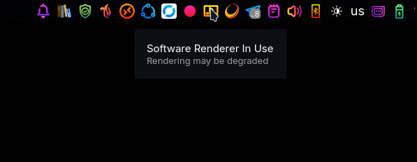

I just noticed on the top toolbar, I have an icon, when hovering over it, says “Software Renderer in Use. Rendering may be degraded”. See here:
I found this in an old thread: Black screen after login on recent update | accelerate software rendering - #7 by nepti
But when I edit the .config/kdeglobals file - those two lines are not there, so that can’t be it.
That said, when I clicked on the icon, it loaded a dialogue box, and I made sure that both drop-downs show “Automatic” (previously “Background renderer” was set to “software”) and hit apply, and rebooted. This restored everything. I have no idea what would have caused this to occur.
